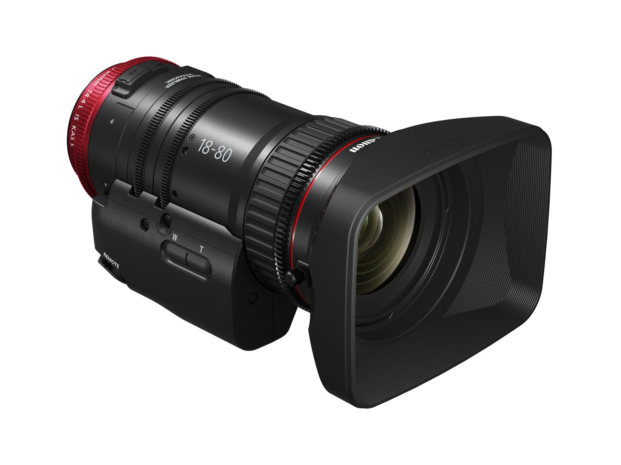

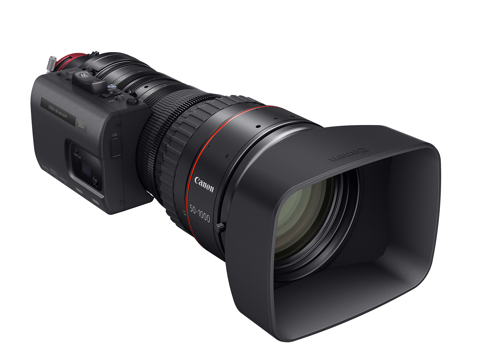

Additional Dual Pixel Auto Focus support for C300 EF with DAF Upgrade
Also, staying with EF lens mount model, you’ll now be able to get full Dual Pixel Auto Focus support for both the Cine-Servo 17-120mm T2.95-3.9 EF, and the Compact-Servo 18-80mm T4.4 EF lenses on EOS C300’s outfitted with the Dual Pixel AF Upgrade.
And when you use the EOS C300 EF with either of those two lenses, or the Cine-Servo 50-1000mm T5.0-8.9 EF, you can also get additional features and functions that those lenses offer -- like servo zoom, continuous Auto-Iris, Push Auto Iris functions, and Record Start/Stop from the lens. Additionally, aperture can be adjusted manually by operating the control dial on the camera. The zoom, focus, and iris can be adjusted using the optional Canon RC-V100 Remote Controller (sold separately). This firmware will also install Peripheral Illumination Correction data for the lenses, and from now on their important lens metadata will be displayed on the camera, recorded, and stored in the file.
CINE-SERVO 17-120mm T2.95-3.9 EFCOMPACT-SERVO 18-80mm T4.4 EFCINE-SERVO 50-1000mm T5.0-8.9 EF
Left to right: CINE-SERVO 17-120mm T2.95-3.9 EF, COMPACT-SERVO 18-80mm T4.4 EF, CINE-SERVO 50-1000mm T5.0-8.9 EF
