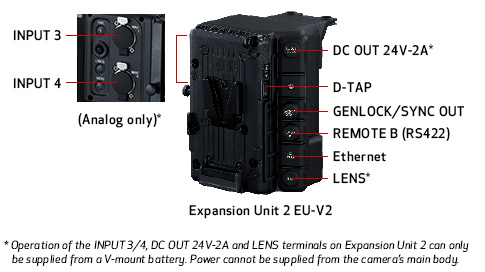

Expansion Unit 2 – EU-V2
This unit converts the EOS C500 Mark II from a compact powerhouse to a full production camera system ready for anything. EU-V2 adds two additional XLR audio inputs, Lens port, 24-volt DC out, and D-Tap power, in addition to Genlock, sync out, Remote B (422) and Ethernet port. It also allows the camera to be powered using industry standard v-lock batteries.

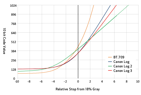

Canon Log 2 and 3 Support
The EOS C500 Mark II supports Canon Log 2 and Canon Log 3 Gamma. In post-production, Canon Log is designed to reproduce the entire tonal range that the CMOS image sensor is capable of. Log workflows provide the user with higher dynamic range, more highlight and shadow retention, and more flexibility in grading.
Canon Log 2 provides the largest dynamic range and image detail. While Canon Log 2 provides the most post-production flexibility and full dynamic range of the sensor, it typically requires more time in color correction.
For users looking for most of the benefits of log workflow, but with shorter turnaround times, Canon Log 3 provides an alternative with only a slightly reduced dynamic range of 14 stops.

Canon OLED Electronic View Finder EVF-V50/EVF-V70
Extension unit 1: EU-V1
Extension unit 2: EU-V2

Canon Log Gamma Curves
12/18/18
0.81 MB
