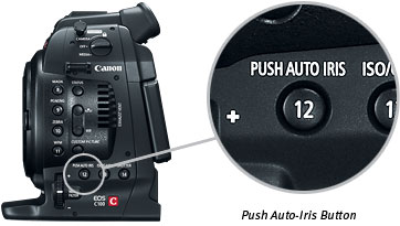

Push Auto Iris
Push Auto Iris automatically adjusts the aperture of the lens to quickly and easily maintain proper exposure, even in situations where lighting changes frequently. Run-and-Gun videographers and documentary filmmakers will appreciate the ability to start rolling without a protracted routine to establish optimum exposure values.

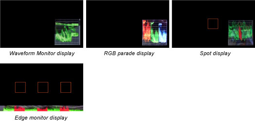

Waveform Monitor
Available; 2 Modes (Standard and RGB Component)
Exposure/Focus Aids
Peaking (2 types), Zebra Pattern*, Magnify, Edge Monitor Focus Assist, Black and White Mode
