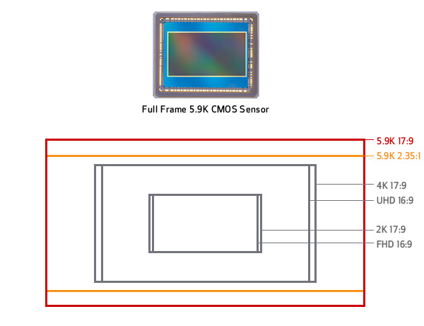

New 5.9K Full Frame CMOS Sensor
The EOS C700 FF Digital Cinema Camera offers a new full frame 5.9K CMOS sensor (38.1 x 20.1mm) with a 17:9 aspect ratio. In addition to full frame lenses, the camera can also be used with conventional Super 35mm lenses, and supports both anamorphic and spherical lenses. The sensor is capable of capturing footage in a wide variety of aspect ratios.
The new sensor also offers exceptional low noise, as well as broad-ranging tonality that exceed 15 stops of dynamic range with a wide color gamut. This helps the EOS C700 FF achieve more natural skin tones and a greater freedom in grading, expanding the possibilities for visual expression and offering outstanding effectiveness in HDR video production.
The EF mount version of the camera also features Canon's Dual Pixel CMOS AF Technology.

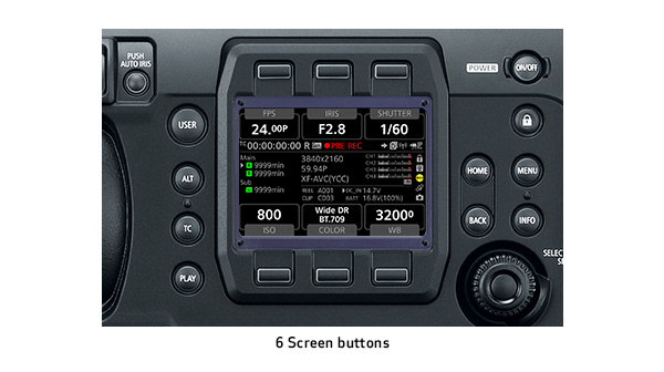

Both sides of the camera can have redundant main displays with menus and controls. A built in control panel on the camera operator side allows quick access to the camera controls. Canon's optional new Remote Operation Unit OU-700 attaches to the camera's right side and mimics all the functions of the built-in Main Display. It conveniently flips up for access to the CFast and SD card slots. This allows for camera operation from both sides of the camera making camera adjustment easy for both operator and assistant.
The intuitive six button layout of the menu system allows quick access to frequently used camera functions such as ISO, shutter, slow and fast motion, etc. and may instantly feel very familiar and comfortable to camera operators. Within each quick access function is the ability to access deeper menu options so complete camera control and customization is always accessible while the menu remains clean and easily usable.

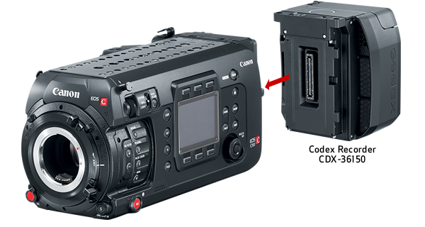

RAW Recording
With an optional Codex CDX-36150 Recorder attached, the EOS C700 FF can record 5.9K RGB Bayer RAW up to 60 fps, 4K RAW (Super 35mm crop) up to 72fps, and 2K RAW (Super 16mm crop) up to 168 fps.
Controlled directly through the cameras menu system, the Codex CDX-36150 is attached to the EOS C700 FF by removing the battery plate at the rear of the EOS C700 FF and replacing it with the recorder. This modularity of the EOS C700 FF allows the recorder to be connected securely without wires and act like an integrated part rather than an external accessory. The rear of the Codex recorder has a battery plate with onboard Gold Mount battery connector. External power (10-32 VDC) can also be supplied to the 2-pin connector on the recorder body.
The Codex Recorder allows recording not only 5.9K RAW, but also ProRes at significantly higher frame rates than internal CFast Cards. When recording, RAW files are saved as a .RMF frame sequence in an uncompressed format with no "baked in settings." Clip development can then be easily adjusted in post using the downloadable Canon Raw Development (CRD) software.
The CDX-36150 uses one Codex Capture Drive 2.0 (1 TB or 2 TB capacity), a familiar and commonly available professional recording media.

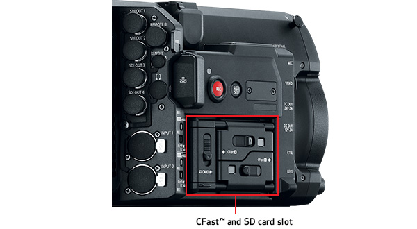

Canon XF-AVC Recording
The EOS C700 FF can record XF-AVC to two CFast 2.0 card slots on the camera right side of the camera. XF-AVC and ProRes formats (along with metadata) can be simultaneously recorded to either or both CFast cards. Simultaneous recording is helpful, for example, where one card might go to the post house and the other could be stored safely in the production company's archive.
Relay recording is also possible for situations where changing cards and losing precious seconds is not an option, such as live events, nature and documentaries.

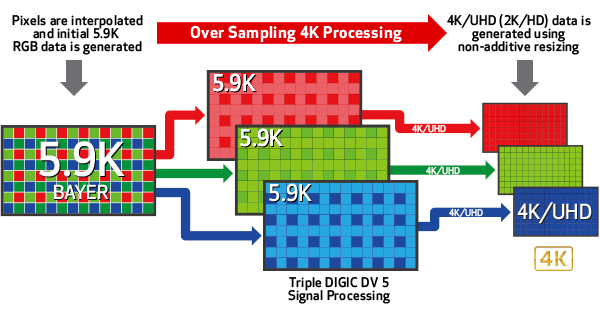

5.9K Oversampling for 4K
The EOS C700 FF Digital Cinema Camera uses a high-quality debayering algorithm when over sampling 5.9K in 4K/UHD recording to suppress moiré and improve noise graininess, resulting in high quality video.

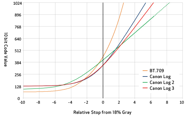

Canon Log 2 and 3
The EOS C700 FF Digital Cinema Camera supports Canon Log 2 and Canon Log 3 Gamma. Canon Log is designed to reproduce, in post-production, the entire tonal range that the CMOS image sensor is capable of. Log workflows provide the user with higher dynamic range, more highlight and shadow retention, and more flexibility in grading. Canon Log 2 provides the largest dynamic range and image detail. While Canon Log 2 provides the most post-production flexibility and the full 15 stops of dynamic range of the sensor, it requires more post time. For users looking for most of the benefits of log workflow, but with shorter turnaround times, Canon Log 3 provides an alternative with only a slightly reduced dynamic range of 14 stops.

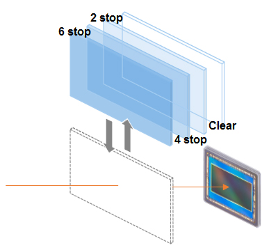

Internal ND Filters
The EOS C700 FF features in-camera ND filters to help save production time and help increase shooting versatility without the need to change filters. The internal ND filters are selected with the ND FILTER + and - buttons on the left side of the camera. The camera uses an internal, all glass motorized ND unit. This combination of ND filters allows 2, 4 and 6 stops of ND in normal mode and 8 and 10 stops in extended mode.

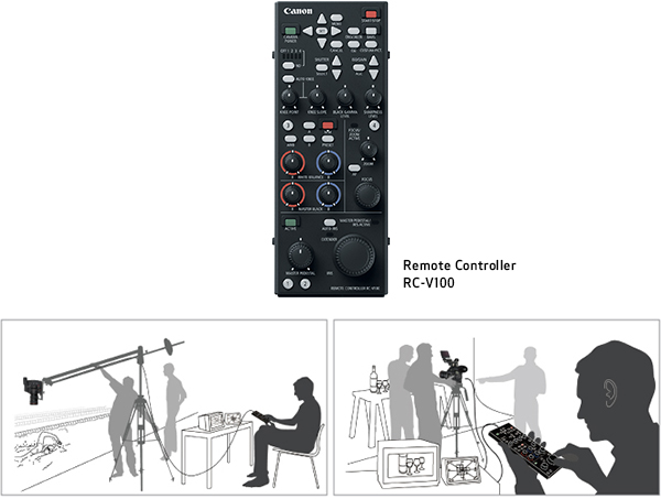

RC-V100 Support
Canon's RC-V100 Remote Controller plugs into the EOS C700 FF via an RS422 connector on the rear panel. This optional accessory allows image quality adjustments and camera operations to be set from a distance.

ND Filter
5 density settings (2, 4, 6, 8*, 10* stops)
*When expansion is selected
Motorized drive
