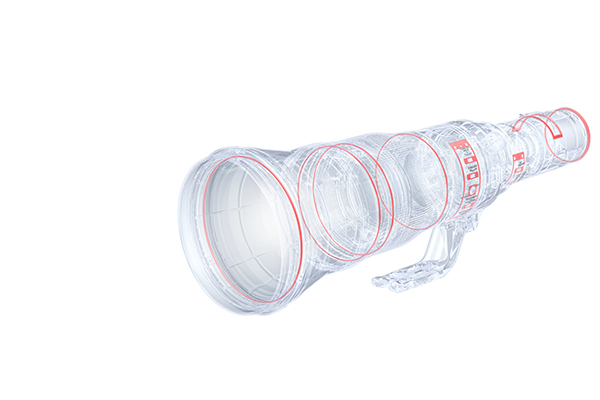

Outstanding Image Quality, 1200mm Super-telephoto Fixed Focal Length Lens Expands the EOS R System.
Optimized magnification optics increase the focal length while retaining nearly the same light weight, portability and high levels of image quality achieved in the RF600mm F4 L IS USM lens. A combination of two large-diameter Fluorite elements, one Super UD (Ultra-low Dispersion) and one UD-glass element provides outstanding sharpness and contrast, even at maximum aperture. A UD lens element positioned in the rear section of the lens provides excellent correction of the increased chromatic aberration generated by the magnification optics. This results in tack-sharp images with minimal color fringing in any shooting condition.

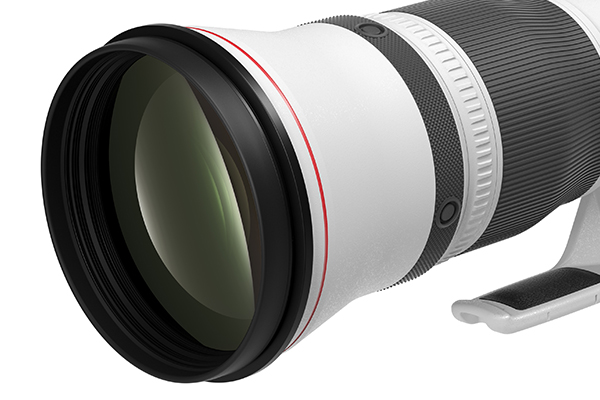

Super Spectra Coating (SSC) and Air Sphere Coating (ASC) Helps Minimize Ghosting and Flare
The RF1200mm F8 L IS USM lens features Canon's Super Spectra Coating (SSC) that helps maintain overall image quality and color fidelity, as well as Air Sphere Coating (ASC), which significantly helps to reduce the occurrence of lens flare and ghosting. This helps provide clean results with minimal flare and loss of contrast, especially in heavily back-lit situations.

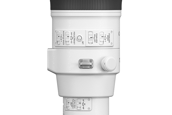

Customizable Electronic Focus Ring, with Manual Focus Capability during SERVO AF
Featuring a customizable electronic manual focus ring on the lens barrel, the RF1200mm F8 L IS USM allows you to select from three different speed levels to adjust manual focus to your desired preference. Adjusted with a 3-position, Manual Focus Speed switch on the lens barrel, Mode 1 provides the “fastest” setting - minimal rotation of the manual focus ring results in significant shifts in actual focus. The Mode 2 and 3 settings add sensitivity, allowing finer focus control as the ring is rotated. The RF1200mm F8 L IS USM therefore allows the user to select a preference for quick, rapid manual focus changes, or fine manual focus adjustments. Additionally, manual focus is still possible while autofocus is engaged, letting you fine tune focus adjustments to suit your shooting preferences.
Two Focus Presets Available - Instantly Return to One or Two Memorized Focus Distances
Quickly select between one or two memorized focus distances, with focus presets. Especially useful for fixed-position sports photography, you can focus upon and memorize two separate focus distances. Then, with a simple twist of the playback ring, immediately jump back to one or the other. A sports photographer, for example, could easily pre-focus on the midfield line and the goal with the ability to rapidly move focus back to either position with a slight turn of the playback ring on the lens barrel.

Durable L-series Construction with Dust- and Water-resistant Design, Fluorine Coating on Front Element for Easy Cleaning
Built to L series lens specifications, the RF1200mm F8 L IS USM features a highly durable design for excellent performance even in inclement weather conditions. It delivers a dust- and water-resistant construction with seals around the mount, switches, rings and more. To help maintain a clean lens, even after multiple lens changes in sub-optimal conditions, the RF1200mm F8 L IS USM has a specially designed fluorine coating on its front and rear surfaces. The coating helps to prevent water, oil, and other surface residue like fingerprints from sticking to the lens, which facilitates quick and easy wiping, without the use of solvents.

Power Focus
Yes, via rotation of Playback Ring
• Lens Focus Preset switch set to OFF; Focus Mode switch set to PF
• Two focus speeds, based on ring rotation angle

AF/MF Switch
YES - AF/PF/MF Switch
MF/Control Ring Switch
None - must be selected in camera menu

Distance Limiter Switch
FULL (2.6 m to infinity) / 2.6 m to 20 m / 20 m to infinity
Focus Pre-set Function
Yes, via Playback Ring on lens barrel
• Off - On - On with beep tone, via lens switch
• Distance memorized via Focus Preset button
• Two distances can be memorized; immediate return to either via direction of Playback Ring
