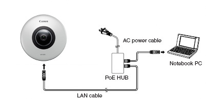

Power over Ethernet
A key component in the compact size of the VB-S30D is the sole use of Power over Ethernet as the method of power, with a maximum usage of 7.8 watts.

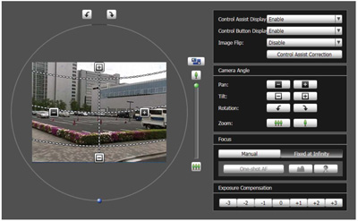

Another feature of the VB-S30D is the Preset Setting Tool which allows the end-user to customize the camera by creating up to 20 presets, thus allowing critical areas to be effectively monitored.
Digital & Viewer PTZ
With the VB-S30D's ability to allow the user to digitally pan, tilt and zoom in the incoming video stream, details in the camera's field of view can be investigated without the need to physically reposition the camera.

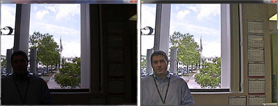

Auto Smart Shade Control
The image quality of the VB-S30D is enhanced by Smart Shade Control. It brightens the underexposed areas of the image, while leaving the properly exposed areas alone. This gives the user an image which is evenly exposed. Those details which might otherwise be hidden in underexposed areas can now be easily identified, without compromising the overall image.
