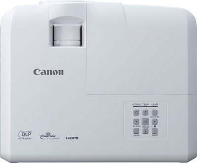

Features
The native XGA (1024 X 768) resolution of the Canon LV-X300ST projector delivers sharp video, diagrams and text in a native 4:3 aspect ratio. For a presenter showing panoramic images, spreadsheets, or material from a laptop, high definition sources or the output of interactive white boards, XGA resolution offers a level of detail above that found in a standard SVGA resolution projector.
In some cases, the 4:3 aspect ratio will also simplify the use for instances where the source and/or screen is in the 4:3 ratio as well.
The Canon LV-X300ST has been designed to deliver its superb images in tight spaces, thanks to the short throw lens. Whether in a small classroom, working with the output of an interactive whiteboard or showing a presentation, you'll be able to project a high quality large image from a relatively short distance from the projection surface. The LV-X300ST's throw ratio of 0.61:1 enables the projection of a 5½ foot wide screen from just under 3½ feet away. You'll have flexibility in placement options without having to compromise on image quality.
The new color processing algorithm and 6-color wheel of the BrilliantColor™ Technology system bring an enhanced level of color realism and richness to your presentations. The reproduction of high-resolution graphics will be natural and lifelike, thanks to the addition of Cyan and Yellow, when compared to a 4-color wheel palette. This has the effect of increasing the saturation of colors, without adding white. The balance of colors displayed will be truer to the original.
Delivering impactful presentations in challenging environments is among the highest of priorities for users. The Canon LV-X300ST meets that challenge head-on with the brilliance of 3000 Lumens. This projector will deliver exceptionally bright, clear, rich images in many applications. The projector's impressive 2300:1 contrast ratio contributes to the projection of images with deep, crisp blacks.
For projecting in multi-purpose rooms such as classrooms or offices, this versatility in performance will be invaluable.

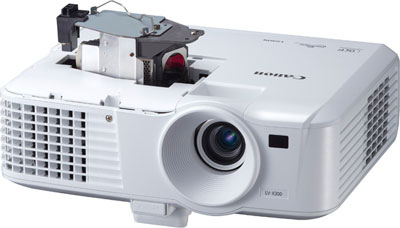

Maintenance of the LV-X300ST is simple with the combination of a filter-free design and an extended-life lamp. In Eco (Economy) Mode, the lamp life is up to 6,000 hours. These features, among the many others, make this projector easy to keep running.
Eco Mode also comes with the bonus of reduced power consumption, as much as approximately 20% from standard mode, along with a reduction in fan noise lowered to 29 dB, helping to reduce the total cost of ownership and making it quieter as well.

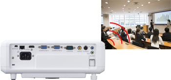

The HDMI input on the LV-X300ST allows projection of engaging high definition signals from various sources such as computers, Blu-ray players and cable boxes.
You will also find 2 Analog PC inputs, 1 Video input, 2 Mini Jacks (audio input and output), 1 Mini DIN4(S-Video) and a USB type B service port.
The Canon LV-X300ST also supports PJLink™, allowing the projector to be controlled and monitored over a network. The administrator may remotely observe lamp hours, usage and more. Additional control options are possible thanks to the RS-232 input and the projector's Creston Connectivity.
