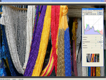

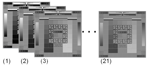

With 21 steps of preset gamma adjustments and custom color temperature controls, the new REALiS SX6000D gives you greater flexibility when adjusting the projector to the lighting conditions of your conference or classroom setting.
Built-in calibration tool has 21 steps of preset gamma adjustments.

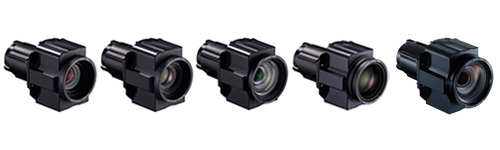

The REALiS SX6000D projector gives you the choice of five interchangeable Genuine Canon lenses. Canon is renowned for our expertise and achievement in lens design and construction - in fact the optical technology developed for our acclaimed EOS series of SLR cameras is reflected in the development of our projection lenses. The 1.5x Zoom Lens (RS-IL01ST), Long Focus Zoom Lens (RS-IL02LZ), Ultra Wide Angle Lens (RS-IL03WF), Ultra Long Focus Zoom Lens (RS-IL04UL), and the Short Focus Zoom Lens (RS-IL05WZ) can be attached to the REALiS SX6000D depending on the application.
A standout feature of these Genuine Canon lenses is their lack of brightness loss compared to lenses fitted to competitor's products. Why is that important? Because you will no longer need to 'over specify' brightness in order to compensate for loss, which is common with wide or long throw lenses. That can have a real impact on the price you pay for your installation projector.
All five lenses share the benefits of specifically designed aspherical lenses to deliver high-quality images with a small footprint. In fact, all five lenses are similar in size and fit in the same space on the projector.

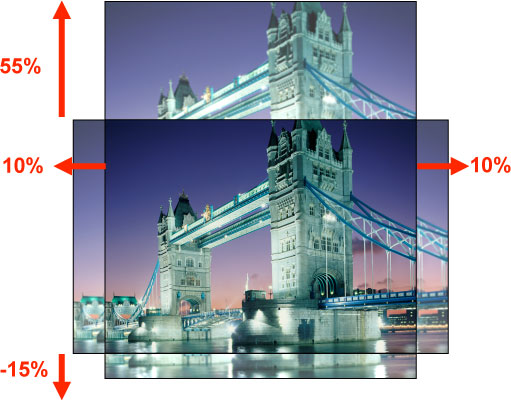

The lens shift capability of all three lenses ably assists in allowing maximum flexibility for a wide variety of installation situations. The range of adjustment for the lenses is as follows:
  • Ultra Wide Angle Lens (RS-IL03WF): Down 5% - Up 5%, Left 10% - Right 10%
  • Standard Zoom Lens (RS-IL01ST): Down 12% - Up 50%, Left 10% - Right 10%
  • Long Focus Zoom Lens (RS-IL02LZ): Down 15% - Up 50%, Left 10% - Right 10%
You can be virtually assured that the REALiS SX6000D can be optimally placed, and since lens shift doesn't degrade the image the way digital keystone correction can, the extraordinary quality of your projected images is not compromised.

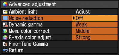

Noise Reduction
In addition, users can utilize a Noise Reduction feature that removes subtle noise artifacts that appear in data from DVD video and other relatively clean content. This function is available for component video and HDMI.
