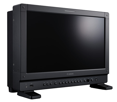

Features
The DP-V1710 UHD 4K Reference Display is perfect for new or retrofit applications in broadcast studios and mobile production vans.
The DP-V1710 fits inside 19" racks making it an excellent choice for broadcast vans that are subject to space and weight restrictions.
The DP-V1710 is 17", perfect for many broadcast applications.

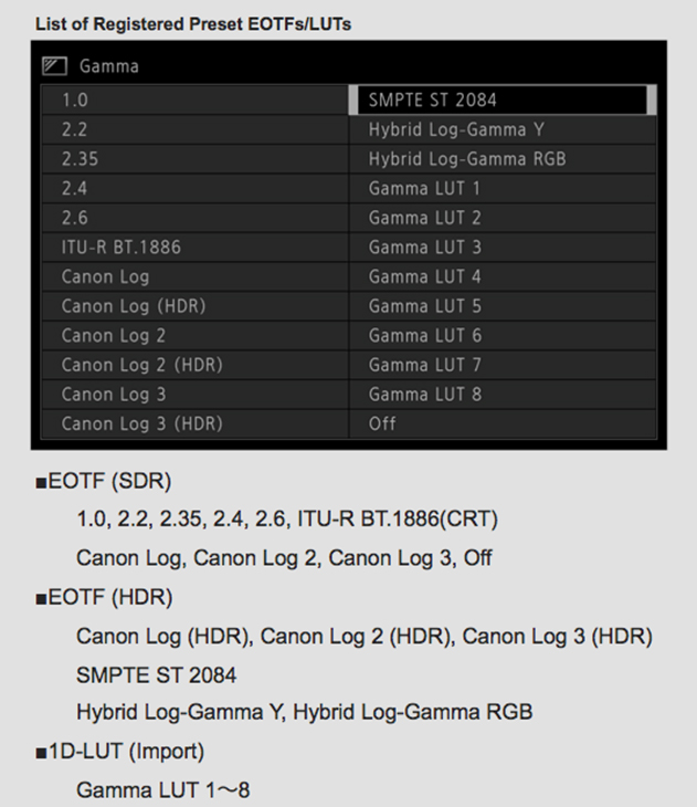

The DP-V1710 UHD 4K Reference Display supports broadcast/digital cinema EOTFs, as well as Canon's own proprietary Canon Log/2/3, and the latest HDR EOTFs, Hybrid Log-Gamma (ITU-R BT.2100) and SMPTE ST 2084. Providing various EOTFs in this way powerfully supports on-location confirmation of video. Up to eight 1D-LUTs created separately can also be imported.

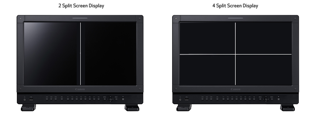

HDR/SDR 2 Split-Screen Display
The DP-V1710 UHD 4K Reference Display supports split-screen display of HDR and SDR signals. Since video can be displayed simultaneously on the left and right screens, differences in luminance ranges and gradation/brightness can be compared at a glance, thus allowing HDR shooting to be conducted with more confidence and efficiency.

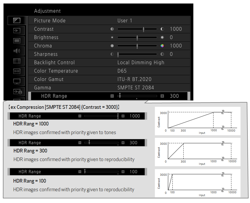

HDR Range Variable Adjustment Function
Variable adjustment of the HDR range is possible to suit specific applications. For example, the dynamic range of the HDR standard signal or LOG signal can be displayed to fit within the luminance supported by the display main unit (range compression), or required actual luminance parts of the range can be displayed with the highlight range area excluded (range upper limit clipping). Desired values can also be registered in advance to function buttons or channel buttons. This lets you call up respective HDR standard videos for confirmation by one-touch operation.

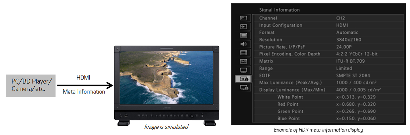

HDR Meta-information Display
Metadata information (color gamut, gamma, maximum luminance, average luminance maximum value of content) from PCs for HDMI-compatible video editing and Blu-ray players, cameras and other devices can be displayed on screen.
This is useful for appropriate HDR productions since videos can be monitored while confirming the HDR information at the same time.

Pre-set Log
Presetting by Cinema EOS System's Canon Log/Canon Log2/Canon Log3 and the ARRI Log C video display are also supported. Log C is preset to the main unit menu. So, all you have to do to check image quality is connect to the camera without having to go through the trouble of adding on any special LUTs.

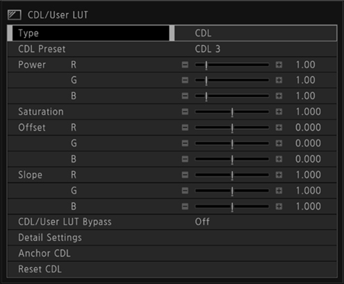

The DP-V1710 UHD 4K Reference Display allows you to set multiple LUTs (8) for each picture mode, same as the DP-V2410 and DP-V2420.
As a result, users can select up to eight LUTs in one picture mode for improved convenience. In addition, presets from CDL1 to CDL15 and a CDL details setting screen have been added. Users can also change the name settings for CDL1 to CDL15.

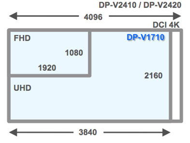

High Resolution
The DP-V1710 features a panel with a 3840 x 2160 resolution and a 16:9 aspect ratio. It can display signals compliant with the digital cinema and high-definition TV broadcast standards on a dot-by-dot basis in exhaustive detail. It makes its three expanded display modes available for 2K or full-HD video productions as well. In this way, it can be used as a FHD/2K/4K display in a wide range of applications, and it contributes to improving the efficiency of 4K/full-HD video production workflows.

2/4 Split-Screen Display Compatibility
In the 2 split-screen display mode, the picture mode can be set independently on displays A and B. And, in the 2 split-screen display/4 split screen display mode, display of the division lines can be switched on and off. The camera information can be displayed at only one location (i.e. one input).

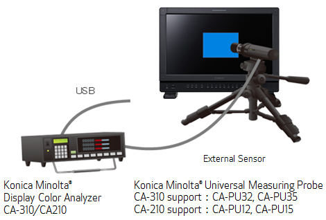

Calibration without a PC
The DP-V1710 achieves the same high level of stability as the DP-V3010/DP-V2410.
In cases where color shifting or other problems have occurred due to the deterioration experienced over the years, accurate corrections can be made using the external sensor (CA-210/CA-310 from Konica Minolta) without having to use a PC.

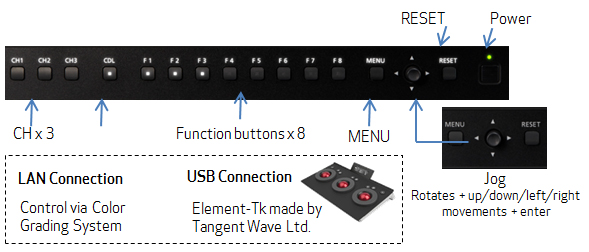

Assignable Function Buttons
Specific functions can be registered to the function buttons in accordance with the intended applications. These functions can then be accessed immediately at the touch of a button.
Easy to Use Control Area
The control area with its function buttons factors in different scenarios for shooting at many different locations, and it is extremely easy to use. The buttons and jog dial are laid out in the same positions as they are on the DP-V2410 display. The labels and buttons on the front panel control area are illuminated to enable operation even in dark places.
If operations are to be performed at a location away from the main unit, users can connect the color grading system using the LAN connector or connect a color grading controller using the USB connector.

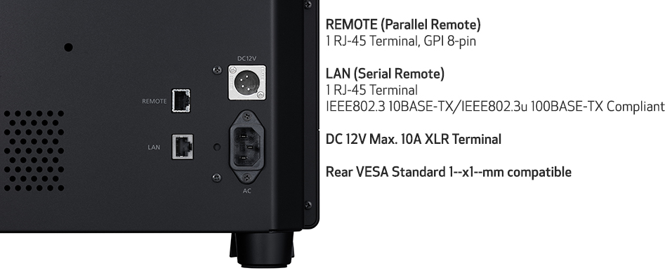

Serial/Parallel Remote Terminals to Enable Remote Control of the Display
Serial/parallel remote terminals are provided for remote control. This enables the operating situation at the shooting location to be confirmed by the tally lamp, and the display to be remotely controlled from a linked third-party grading system.

12 V DC (XLR Terminal) Support
The DP-V1710 UHD 4K Reference Display can be powered by a 12 V DC source which allows the display to be used in the field when producing remote segments, dramas and documentaries, for example.

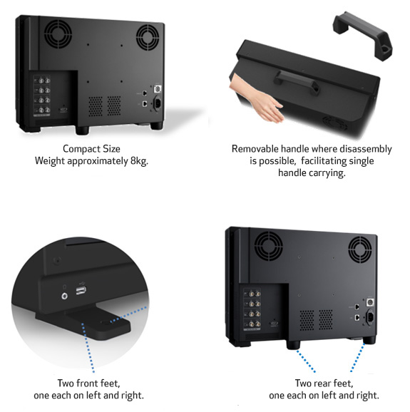

High Rigidity with Aluminum Frame
The aluminum frame design offers rigidity and strength. The front body design is based on the DP-V2410 display design concept, which offers minimal noise as to not interfere with production work.
EIA 19"Rack Mount Compatibility
The display can be installed with optional brackets for installing the rack mount.
High Mobility and Installability Suited for On-set Use
6G/3G/HD-SDI and HDMI are equipped as standard, and interfaces required for video production locations are supported.
