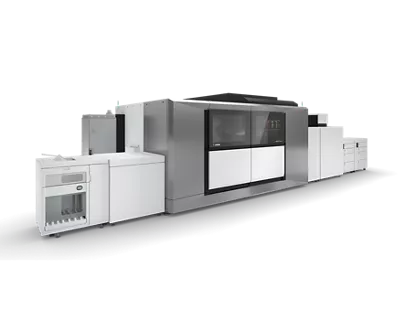

varioPRINT iX3200
VPIXPRNT MOD
As low as $0.00
Out Of Stock
  • More than 18,500 letter images per hour and 312 letter images per minute
  • High-end PRISMAsync controller with eight hours plan-ahead production
  • All-in-one print platform with end-to-end automated workflow
  • Minimum job set-up time without daily calibration
  • Up to three hours without paper loading thanks to maximum 23,400 letter or 13,500 sheets any format paper input capacity

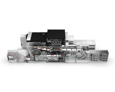

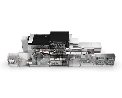

With the varioPRINT iX3200 press, Canon launches iQuariusiX, the next generation of this proven technology.
iQuariusiX technology takes the guesswork out of the science that enables ink and paper to work together. It makes it possible to handle a wide range of media and to print at incredibly high speeds while retaining razor-sharp details, outstanding color, and a perfectly flat finish.
iQuariusiX is based on four technology innovations:
  • Quality control: For consistent quality on all applications
  • Ink innovation: For superior quality on a wide range of media
  • Drying technology: For a robust end result, ready for post-processing
  • Media transport: For reliable and accurate, non-stop operations and handling of all media

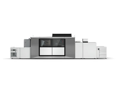

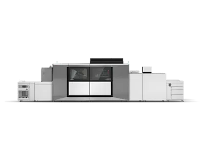

Main Unit Specs
TECHNOLOGY
Print technology
Inkjet, Drop-on-demand, piezoelectric
Ink
Proprietary polymer pigment water-based iX inks
Drop size
Variable, MultiLevel
Print speed
varioPRINT iX3200:
312 letter duplex images per minute
9,360 8.5 x 11 sheets 4/4 per hour
4,170 14 x 20 sheets 4/4 per hour
Duty cycle
varioPRINT iX3200: 1,000,000 – 10,000,000 letter
impressions/month
Print resolution
1200 × 1200 dpi
PAPER
Paper weight
Uncoated: 60 - 350 gsm
Coated: 90 - 350 gsm
Substrates
Commodity coated and uncoated papers including specialties
Standard configuration
2 Paper Input Module (PIM Flex XL)
1 High Capacity Stacker
Paper sizes
PIM Flex XL: All sizes between 8” x 8” and 14 x 20” supported
Maximum printable area
13.3 x 19.8
Paper capacity
3 PIMS x 4,600 sheets per PIM (13,800) 20 lb. bond
PAPER INPUT MODULE FLEX XL
Paper trays
Duo Paper Trays
Standard paper capacity
4,500 sheets
Paper size
Paper trays 1 and 2: 600 sheets 20 lb. bond 8 x 8 to 14 x 20
Paper trays 3 and 4: 1,700 sheets 20 lb. bond 8 x 8 to 14 x 20
Dimensions (W×D×H)
3.2 x 1.2 x 4.6
Weight
Approximately 15,900 lbs. (main engine, 2 PIMs, 1 HCS)
HIGH CAPACITY STACKER
Stacks
2 × 3,000 sheets (80 gsm) per stacker
INTEGRATED CAMERA MOUNTING UNIT (OPTIONAL)
Inline camera inspection
PRISMASYNC CONTROLLER
Network connectivity
Internal: 1 x 10 Gbit Ethernet; External: 2 x 1 Gbit (10/100/1000 Base-T), TCP/IP (LPR /LPD, 9100 Socket), Static IP / Auto-IP (DHCP), IPv4, IPv6 (only in Document printing mode)
Page Description Languages
PDF 1.7 (Extension Level 3), APPE DP mode is 5.4, APPE for TP mode is 4.9, PDF/VT (Level 1), Postscript, PPML 2.2, IPDS IS/3, SRA PCL6
Job submission
lpr, Hotfolders via WebDAV, Socket (streaming), JDF/JMF, IPP 2.0, Remote PDF Driver
Protocols
SNMP v1, SNMP v3, Host Resources MIB, MIB II, Printer MIB, Job Monitoring MIB, Job Management MIB (partially), IEEE 802.1x
Spot Color Libraries
PANTONE+ Solid (Coated & Uncoated), PANTONE GOE (Coated & Uncoated), HKS (K,N), HKS (K,N) 3000+
PANTONE+ Solid 336 New (Coated & Uncoated)
CONNECTION REQUIREMENTS
Connection fuse
230/400 VAC, 100A; 100-240 VAC, 13-20A; 100-240 VAC, 13-20A; 200-240 VAC, 13-20A; 100-240 VAC, 13-20A
Power consumption printing
14.9 kW
Power consumption idle
7.1 kW
Power consumption sleep
0.9 kW
Compressed air
5-12 bar, dry and oil free
Water
Reverse osmosis water system
ENVIRONMENTAL
Temperature
Required range 20–26 °C, 68-78.80 Fahrenheit
Humidity
Required range 40–60%
Operating noise
Printing 72 dB, Standby 61 dB
PHYSICAL DATA[1]
Length × Width × Height
33 x 9.2 x 7.3
