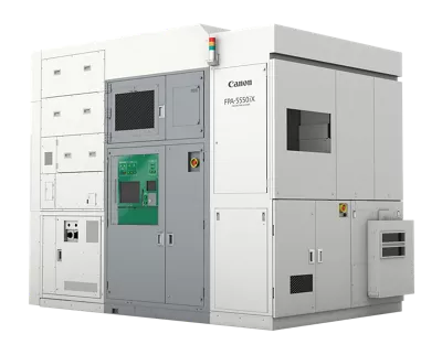

FPA-5550iX Stepper
FPA-5550iX steppers adopt a high-NA, 1/2 reduction projection lens to deliver 0.5 um resolution across a large 50 mm x 50 mm exposure field. The FPA-5550iX is suitable for production of full-field image sensors and advanced augmented reality displays that are larger field than Front-End-Of-the-Line (FEOL) lithography exposure fields (26mm x 33mm) and FPA-5550iX steppers can help avoid pattern stitching of adjacent fields that can directly affect yield.

Overview
- FPA-5550iX steppers deliver stable performance for a variety of applications
- FPA -5550iX utilizes the same projection lens used by its predecessor FPA -5510iX stepper (released in September 2015) that enable 0.5μm resolution
- FPA-5550iX manufacturing processes have been refined to ensure high-quality, stable production of projection lenses to meet the demand expected for semiconductor lithography systems
- Wide exposure field of 50 x 50 mm allows high-resolution single exposure of full-frame image sensors, next-generation displays for augmented reality displays
- FPA-5550iX alignment system allows process optimization
- Wafer alignment scope that can read wider variety of alignment marks that are placed on silicon wafers to ensure layer-to-layer overlay accuracy
- Dark-field alignment mark illumination using scattered and diffracted light is available in addition to conventional bright-field direct mark illumination to enhance mark contrast and measurement accuracy
- Expansion of the usable alignment illumination wavelength ranges and adoption of an area sensor for multi-pixel measurement can help reduce measurement signal noise the system can detect and measure low-contrast alignment marks FPA-5550iX alignment system allows process optimization
- FPA-5550iX stepper options support advanced process optimization
- Through-Silicon Alignment (TSA) option enable users to use infrared light source to perform front-to-back overlay of alignment marks on the backside of silicon wafers. TSA is a requirement for the manufacturing of backside-illuminated sensors and through-silicon via application
- Canon’s Lithography Plus solution option (released in September 2022) can enable FPA-5550iX operators to monitor the condition of the lithography system and perform analyses to maintain quality control and utilization
