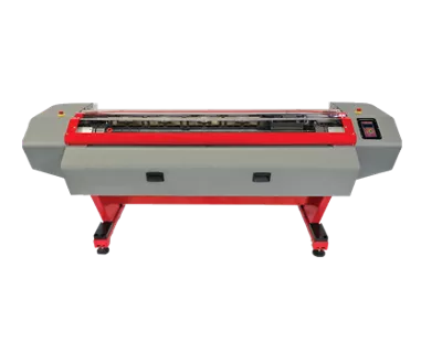

A big step forward to finishing automation!
The XLA170 is controlled by a barcode reader. When the printed size on the roll media changes, the XLA170 stops and moves the slitters into the correct position and continues to cut automatically. Barcode reader is supported by Onyx, Caldera, and PrintFactory.
Features
The Fotoba XLA170 offers automation, helping to increase productivity and reduce labor costs.
Bar Code Reader:
A bar code is printed on the sheet outside of the image, then the bar code reader interprets the cut data, and the vertical rotary slitters are set to the cut position automatically.
Slitter Automation:
The XLA170 features six double rotary slitters with the ability to cut up to five equal size prints, side by side. If there are less than five print sizes, side by side, the rotary slitters move out of the way automatically.
Productivity:
In the past, different image sizes in the same media roll required the operator to stop the cutter, reposition the vertical slitters, and restart the cutter for each image change. The new Fotoba XLA170 does this operation automatically.
Applications:
The Fotoba XLA170 automatic digital cutter, combined with the Colorado 16XX and other roll to roll printers, opens a wide range of graphic applications for the print service provider. The Fotoba XLA170, can cut a wide variety of materials that include and are not limited to; wall coverings, floor graphics, paper, posters, SAV (decal material), stickers, banner, window graphics, signs, and canvas.
Wallpaper:
The XLA utilizes technology for high precision cutting applications such as butt joint wallpaper installation applications. The XLA affords the opportunity to eliminate wallpaper overlap for a smooth continuous look for wallpaper décor.
Fotoba Finishing System
Fotoba XLA can be a total finishing system by adding loading, rewinding, taping, and stacking accessories.
  • JRL170 - Jumbo Roll Loader for jumbo rolls of media
  • Rewinder REW162 - multipage rewinder which rewinds wallpaper into coreless rolls
  • Label Dispenser (this is not a printer) – automatic taping of coreless rolls, ready for fulfillment
  • Exit Stacker – stacker to receive printed sheets and stack finished media
Fotoba XLA170 Cutter System
Description Automatic X/Y cutter with extreme cut accuracy.
Compensation Self-squaring to the edge of the image (X)
Sensor Automatic barcode reader and slitter alignment to vertical axis
Automatic Automatic scanning of barcode made with RIP software
Versatility Automatically adjust cuts of sheet size and quantity up to 5 images on the web width of the media
Max. Cutting Width 64 inches
Min. Cutting Width 8 inches
Min. Supply Roll Width 33.5 inches
 Cutter Dimensions & Weight 110" x 34" x 44"   /  550lbs
Shipping Dimensions & Weight 119" x 48" x 57"   /  1,200lbs
Substrates Up to 40 mil thick
Memory Memory channels to store different cut marks
Blades Self-sharpening blade system
Accuracy X ±0.5 mm (0.02"), Y ±0.06 mm (0.002")
Loading Auto-grip for easy loading of media
Cutting Six (6) vertical slitters included; no additional slitters can be added
Motor Mechanism controlled by stepper motors
