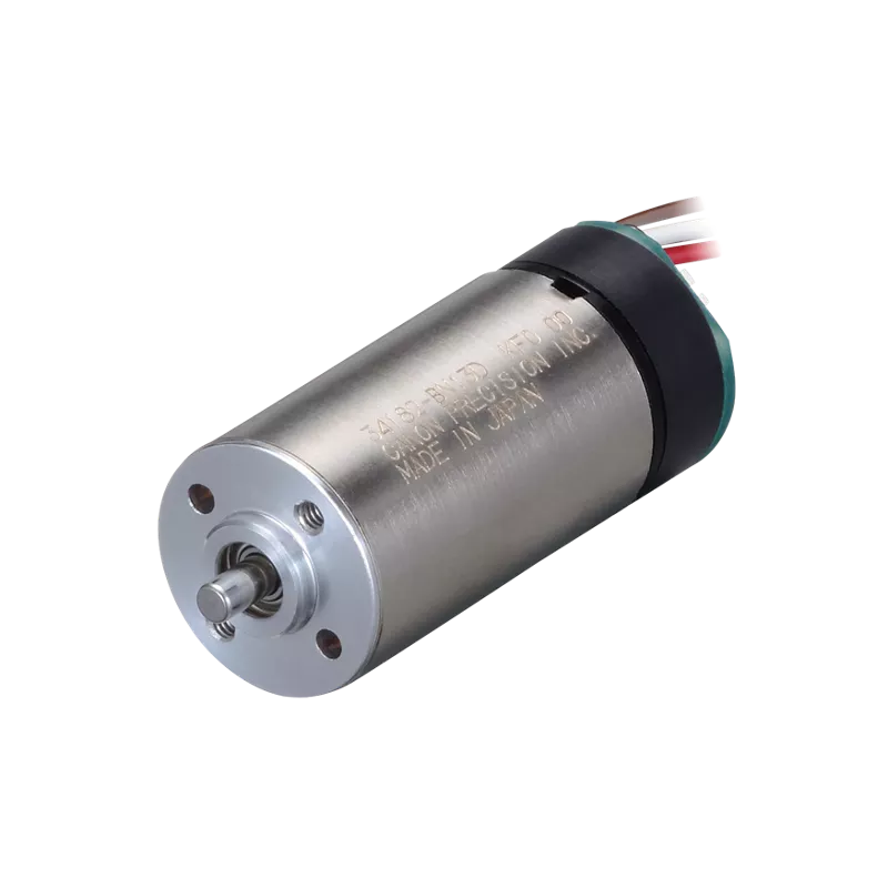

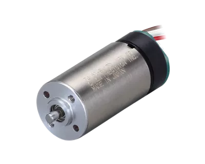

BN13
As low as $0.00
Out Of Stock
  • Coreless BLDC motor
  • Size: φ13mm
  • Comact in size
  • High output power
Show more
Model Name Model No. Diameter Length Rated
Voltage
Rated Output Rated
Torque
Rated Speed Rated
Current
No Load
Speed
No Load
Current
Starting
Torque
Starting
Current
Torque
Constant
Shaft
Diameter
Weight
Φ mm V W mN・m gf・cm r/min A r/min A mN・m gf・cm A mN・m/A gf・cm/A mm g
BN13 BN13 12.9 27.5 24 7.07 3.43 35 0.48 0.12 24,300 0.12 18.13 184.9 2.02 8.3 84.6 2 17
BN13+ENC BP13 12.9 27.5 24 7.07 3.43 35 0.48 0.12 24,300 0.12 18.13 184.9 2.02 8.3 84.6 2 17
Model Name Model No. Reduction
Ratio
Number
of Phase
Input
Voltage
Resolution Response
Frequency
Encoder
Type
Output
Level
Output
Signal
V P/R kH(z MAX)
BN13 BN13 - - - - - - - -
BN13+ENC BP13 - 3 3.3 256 16,000 Magnetic TTL Digital
