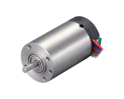

BN22
As low as $0.00
Out Of Stock
  • Coreless BLDC motor
  • Size: φ22mm
  • Comact in size
  • High output power
  • Longer life compared to conventional motors
Show more
