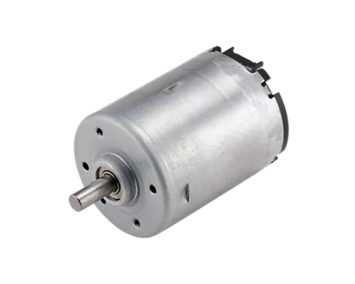

  • BLDC motor (iron cored)
  • Size: φ44mm
  • Compact in Size
  • Provide high output power
  • Quick response
  • High Controllability
Show more
Model Name Model No. Diameter Length Rated
Voltage
Rated Output Rated
Torque
Rated Speed Rated
Current
No Load
Speed
No Load
Current
Starting
Torque
Starting
Current
Torque
Constant
Shaft
Diameter
Weight
Φ mm V W mN・m gf・cm r/min A r/min A mN・m gf・cm A mN・m/A gf・cm/A mm g
BN44 BN44 44 57 24 19.48 49.03 500 1.25 0.28 5,000 0.28 204.31 2,083.30 4.32 50.5 515 6 370
