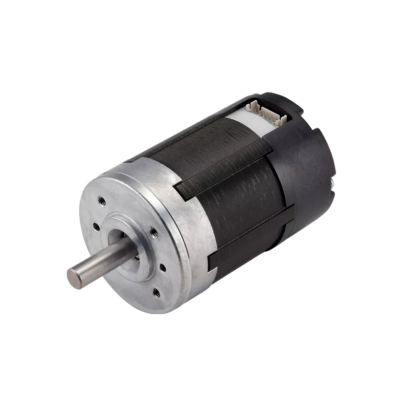

  • BLDC motor (iron cored)
  • Size: φ54
  • Compact in Size
  • Provide high output power
  • Quick response
  • High Controllability

Model Name Model No. Diameter Length Rated
Voltage
Rated Output Rated
Torque
Rated Speed Rated
Current
No Load
Speed
No Load
Current
Starting
Torque
Starting
Current
Torque
Constant
Shaft
Diameter
Weight
Φ mm V W mN・m gf・cm r/min A r/min A mN・m gf・cm A mN・m/A gf・cm/A mm g
BN54 BN54 54 80 24 28.29 117.68 1,200 1.85 0.3 3,440 0.3 355.1 3,621.10 4.98 76.13 776.3 8 740
