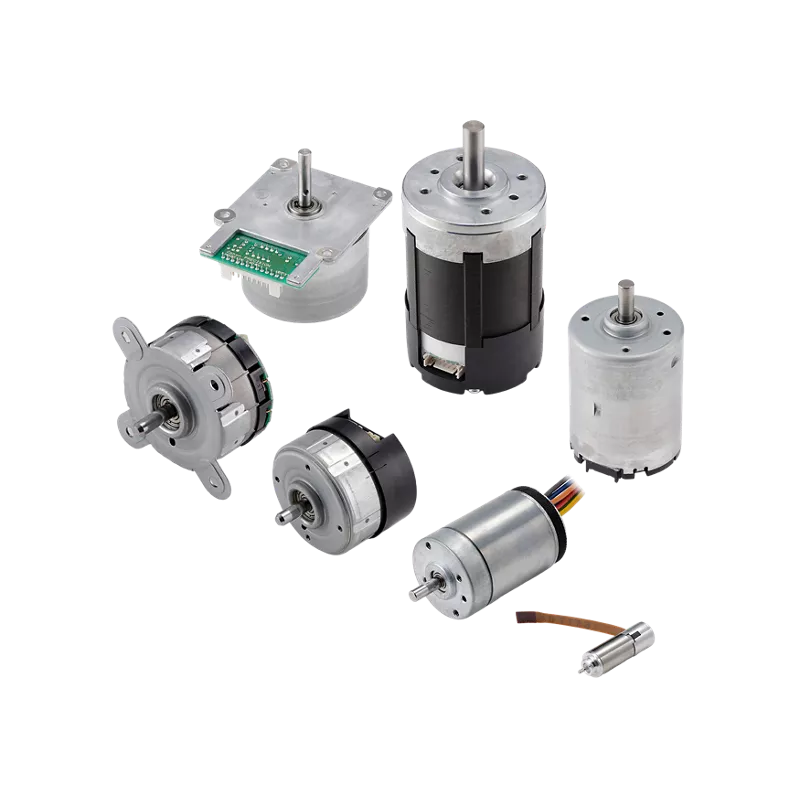

  • Size range: φ13 - 54mm
  • Comact in size
  • High output power
  • Both coreless/cored type is available
Show more
