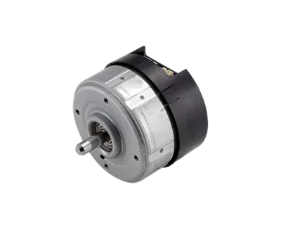

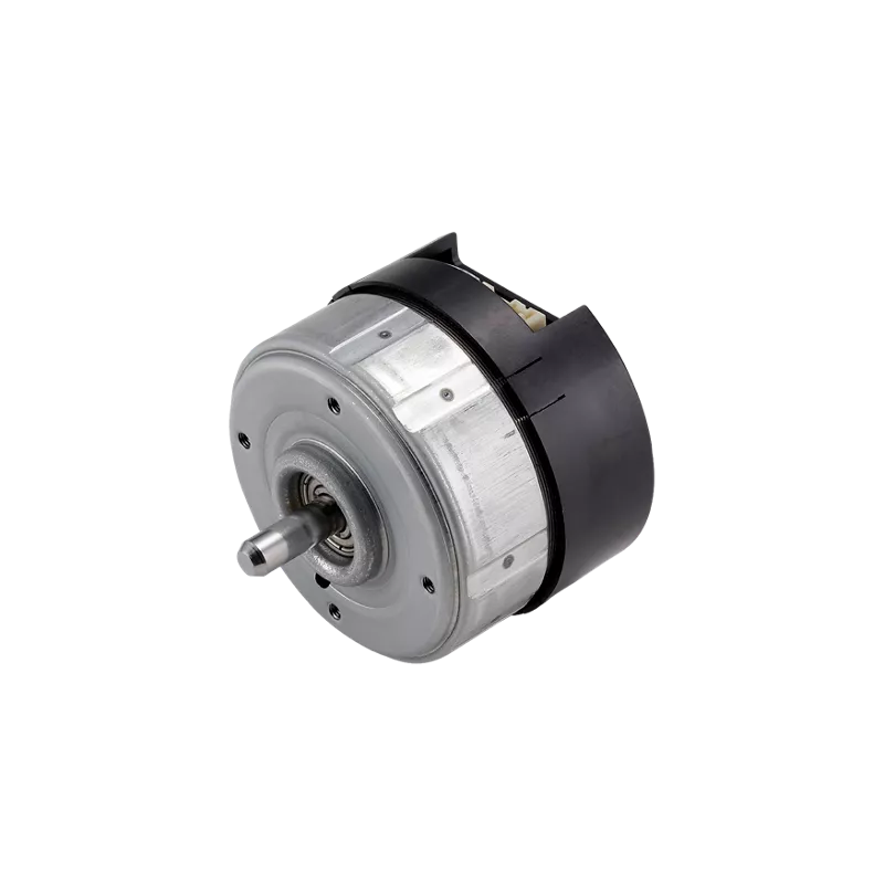

  • BLDC Motor (iron cored)
  • Size: φ54mm
  • High efficiency (Max. 80% Rated 75%)
  • High torque
  • Low noise
  • Smooth rotation
  • Accurate positioning
