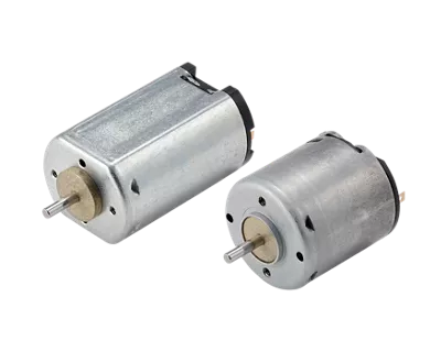

DN22
As low as $0.00
Out Of Stock
  • Iron cored motor
  • Size: φ22mm
  • Engineered and manufactured in Japan
  • Designed for stable operation and long‑term reliability
  • Options: gears, encoders, lead wires, etc.
  • Motor characteristics can be adjusted to customer requirements
Show more
Model Name Model No. Diameter Length Rated
Voltage
Rated Output Rated
Torque
Rated Speed Rated
Current
No Load
Speed
No Load
Current
Starting
Torque
Starting
Current
Torque
Constant
Shaft
Diameter
Weight
Φ mm V W mN・m gf・cm r/min A r/min A mN・m gf・cm A mN・m/A gf・cm/A mm g
DN22 S DN22 S 22 23 12 2.2 2.45 25 8,600 0.34 11,500 0.06 9.72 99.1 1.17 8.31 84.7 2 26
DN22 S+ENC DP22 S 22 30 12 2.2 2.45 25 8,600 0.35 11,000 0.06 11.24 114.6 1.39 8.09 82.5 2 45
DN22+GEAR DG22 S 22 41.4 6 1.11 78.45 800 135 0.46 165 0.13 431.49 4,400 1.95 - - 8 75
DN22+GEAR DG22 S 22 41.4 12 1.19 78.45 800 145 0.27 170 0.09 533.48 5,440 1.31 - - 8 75
DN22 M M-Speed DN22 M M 22 32.8 12 1.38 2.45 25 5,400 0.19 6,800 0.04 11.91 121.4 0.79 15.11 154.1 2 40
DN22 M M-Speed DN22 M M 22 32.8 24 1.38 2.45 25 5,400 0.1 6,800 0.02 11.91 121.4 0.41 29.15 297.2 2 40
DN22 M H-Speed DN22 M H 22 32.8 12 1.79 2.45 25 7,000 0.23 8,200 0.05 16.75 170.8 1.31 12.8 130.5 2 40
DN22 M H-Speed DN22 M H 22 32.8 24 1.74 2.45 25 6,800 0.13 8,100 0.03 15.28 155.8 0.65 23.57 240.4 2 40
Model Name Model No. Reduction
Ratio
Number
of Phase
Input
Voltage
Resolution Response
Frequency
Encoder
Type
Output
Level
Output
Signal
V P/R kH(z MAX)
DN22 S DN22 S - - - - - - - -
DN22 S+ENC DP22 S - 1 3 3 - Magnetic TTL Digital
DN22+GEAR DG22 S Jan-62 - - - - - - -
DN22 M M-Speed DN22 M M - - - - - - - -
DN22 M H-Speed DN22 M H - - - - - - - -
