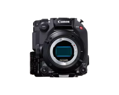

Impressive usability and imaging power combine in the EOS C500 Mark II, the customizable full frame cinema camera that’s built for creative freedom.
The lightweight body comes equipped with Canon's 5.9K full-frame CMOS sensor capable of over 15 stops of dynamic range. The newly developed DIGIC DV 7 Image Processor expands functionality and flexibility by enabling features such as 5.9K recording, internal recording of Canon Cinema Raw Light and Dual Pixel Autofocus.
The Cinema EOS C500 Mark II is the perfect expression of form and function, exceptionally adaptable to virtually any production with its modular design. Three expansion units and user changeable lens mounts enable operators to build their ideal cinema system.

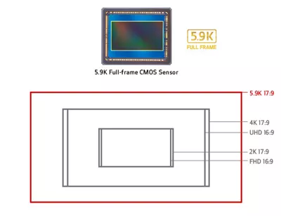

5.9K Full Frame CMOS Sensor, with support for Super 35mm and Super 16mm crop modes
The Cinema EOS C500 Mark II features Canon’s high-resolution 5.9K (38.1 x 20.1mm) Full Frame CMOS sensor, which offers exceptional low noise and a broad range of tonality with over 15 stops of dynamic range. The sensor’s expansive native cinema gamut goes beyond that of current standards, including ITU-R BT.2020 and DCI-P3, helping the EOS C500 Mark II achieve more natural skin tones and allowing for greater freedom in color grading in both SDR and HDR productions.
The Full Frame sensor is capable of capturing footage in a wide variety of aspect formats, including DCI-4K, UHD and Anamorphic Widescreen. The Cinema EOS C500 sensor supports both anamorphic and spherical lenses. In addition to full-frame, the sensor can also be paired with conventional Super 35mm and Super 16mm lenses using appropriate sensor crop modes, lens mount and adapter.
5.9K Full-frame CMOS Sensor

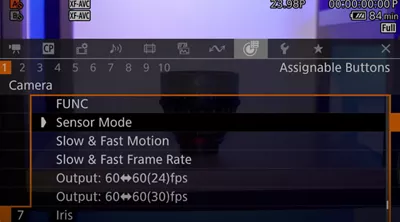

Sensor Mode Selection
Sensor Mode selection has been simplified to just the touch of a button. As a time saver, toggling between Full-Frame, Super 35 or Super 16 crop modes can be designated to one of the camera's assignable buttons.
Sensor Mode

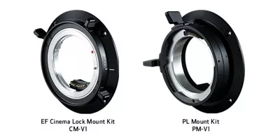

The EOS C500 Mark II ships with an EF Mount that can be user swapped to an optional Locking EF (EF-C) or PL mount. Each mount swaps easily by simply removing four M3 hex screws. A shim set is provided with each mount kit in order to adjust back focus for the precision in focusing accuracy that professionals rely on.
*Dependent on the mount the user has in place
EF Cinema Lock Mount Kit and PL Mount Kit

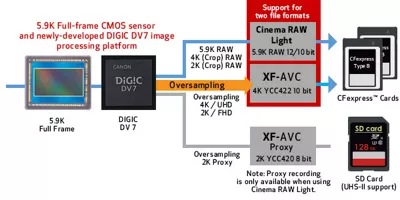

Canon Cinema RAW Light and XF-AVC Recording
Thanks to the powerful DIGIC DV 7 image processing platform, the EOS C500 Mark II can record Cinema RAW Light directly to onboard CFexpress cards, which keeps the data-rich signal captured by the 5.9K full-frame sensor intact. Cinema RAW Light offers plenty of freedom for grading in file sizes that are about 1/3 to 1/5 the size of Cinema RAW, offering a great combination in terms of codec efficiency and quality.

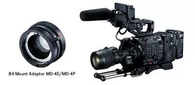

The amount of viable lens options can be further increased through an optional B4 lens mount adapter. This adapter is available for the PL or EF mount allowing 2/3” lensing options to be used with the camera.
B4 Mount Adapter MO-4E/MO 4P image

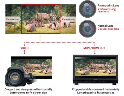

Anamorphic Lens Support
The EOS C500 Mark II offers cinematographers anamorphic lens support. Users can now achieve wide cinematic looks and oval bokeh particular to anamorphic glass. It is a distinctly cinematic palette that is within reach for your next project.

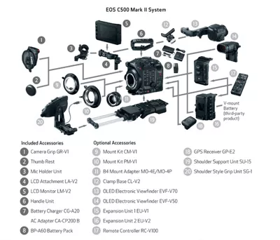

Modular Design with three available Expansion Units allows a high level of connectivity and interoperability
A new modular design allows productions to optimize and customize the EOS C500 Mark II to specific shooting needs. Accessories and expansion units can be easily attached to provide different levels of functionality. The camera is equally at home fully rigged with a large zoom lens, FIZ unit, audio accessories and rangefinder as it is stripped down flying on a drone.
EOS C500 Mark 2 System

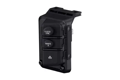

Expansion Unit 1 – EU-V1
This unit extends connectivity that benefits both remote operation and live uses of the EOS C500 Mark II. This expansion adds genlock/sync out, remote B (RS422) and Ethernet ports ideal for multi-camera, streaming and live television applications.

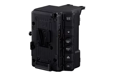

Expansion Unit 2 – EU-V2
This unit converts the EOS C500 Mark II from a compact powerhouse to a full production camera system ready for anything. EU-V2 adds two additional XLR audio inputs, Lens port, 24-volt DC out, and D-Tap power, in addition to Genlock, sync out, Remote B (422) and Ethernet port. It also allows the camera to be powered using industry standard v-lock batteries.

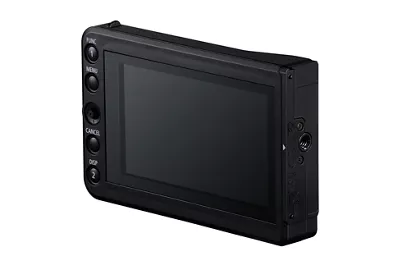

4.3” LCD Touch screen Monitor LM-V2
The new LM-V2 4.3” LCD Monitor is an easy to view touch panel with approx. 2.76 million dots. The monitor easily attaches to the EOS C500 Mark II using included accessories and can be adjusted to different viewing positions. In addition to image framing and visual confirmation of camera settings, attached controllers make it easy to access and change camera settings.
With the December 2024 firmware update, the EOS C500 Mark II will add the option to output a peripheral border display from its. 12G-SDI and HDMI interfaces.

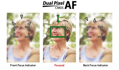

Dual Pixel CMOS AF with support for Touch AF and Face Detection AF
The Cinema EOS C500 Mark II features Canon’s Dual Pixel CMOS AF Technology. For DPAF, each pixel in the camera’s CMOS sensor is configured with two photodiodes. Two independent image signals can then be detected at each photosite and compared using phase-difference to provide autofocus with compatible lenses. DPAF can survey the scene and recognizes not only whether the subject is in focus or not, but in which direction (near or far), and by how much. DPAF also powers the intuitive Focus Guide for users who prefer to focus manually but enjoy the positive feedback DPAF provides through the guide interface.

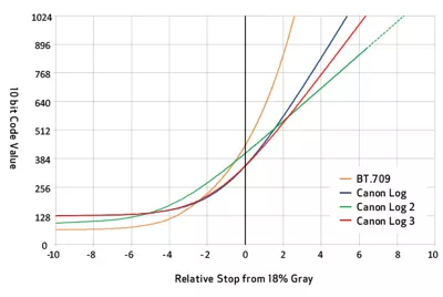

Canon Log 2 and 3 Support
The EOS C500 Mark II supports Canon Log 2 and Canon Log 3 Gamma. In post-production, Canon Log is designed to reproduce the entire tonal range that the CMOS image sensor is capable of. Log workflows provide the user with higher dynamic range, more highlight and shadow retention, and more flexibility in grading.
Canon Log 2 provides the largest dynamic range and image detail. While Canon Log 2 provides the most post-production flexibility and full dynamic range of the sensor, it typically requires more time in color correction.
For users looking for most of the benefits of log workflow, but with shorter turnaround times, Canon Log 3 provides an alternative with only a slightly reduced dynamic range of 14 stops.
Canon Log

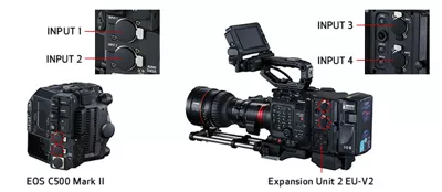

4 Channel Audio Recording
With Expansion Unit EU-V2, the EOS C500 Mark II supports up to 4-channel audio recording. Audio input from the camera’s internal microphone, mini mic port, and XLR ports can be assigned to the 4 different audio channels. This flexibility allows a wide range of audio devices to be connected and mixed directly on the camera.
