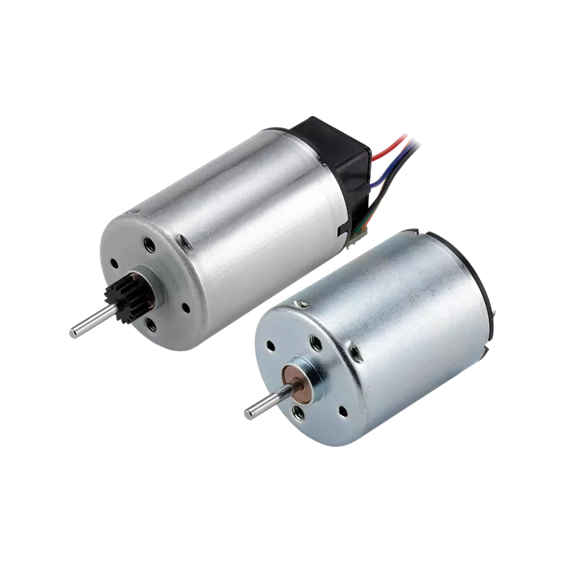

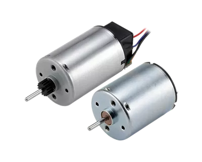

FN30
As low as $0.00
Out Of Stock
  • Iron cored motor
  • Size: φ30mm
  • Engineered and manufactured in Japan
  • Designed for stable operation and long‑term reliability
  • Options: gears, encoders, lead wires, etc.
  • Motor characteristics can be adjusted to customer requirements
Show more
Untitled Document
Model Name Model No. Diameter Length Rated
Voltage
Rated Output Rated
Torque
Rated Speed Rated
Current
No Load
Speed
No Load
Current
Starting
Torque
Starting
Current
Torque
Constant
Shaft
Diameter
Weight
Φ mm V W mN・m gf・cm r/min A r/min A mN・m gf・cm A mN・m/A gf・cm/A mm g
FN30 L FN30 L 30 55 24 4.77 14.71 150 3,100 0.35 4,400 0.04 49.79 507.7 1.09 45.71 466.1 4 160
