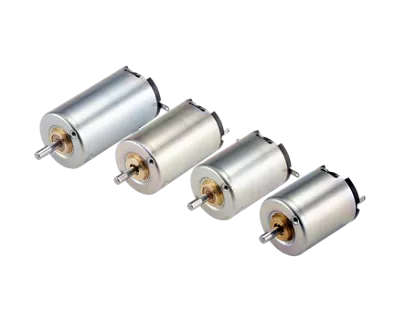

FN38
As low as $0.00
Out Of Stock
  • Iron cored motor
  • Size: φ38mm
  • Engineered and manufactured in Japan
  • Designed for stable operation and long‑term reliability
  • Options: gears, encoders, lead wires, etc.
  • Motor characteristics can be adjusted to customer requirements
Show more
