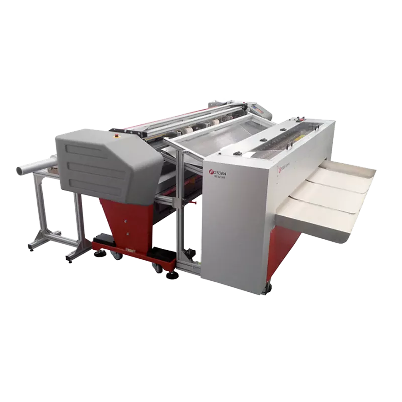

  • Automatic X/Y cutter for rolls and sheets up to 67” wide
  • Versatile Fotoba wide format cutter designed to cut flexible media up to 40 mil thick
  • Automatic realignment and compensation while cutting
  • Optical detection of cut marks placed by RIP software
  • Very high Y trimming accuracy of ±0.002” (±0.06 mm) and high X trimming accuracy of ±0.02” (±0.5 mm)
  • Optional automatic in-line rewinder available
Show more
Fotoba Cutter System
Description Versatile X/Y cutter with extreme cut accuracy.
Compensation Self-squaring to the edge of the image (X)
Sensor Automatic tracking and realignment to the image (Y)
Automatic Automatic scanning of cut marks made with RIP software
Versatility Adjustable cuts of media lengths and quantity
Substrates Up to 40 mil thick
Memory Memory channels to store different cut marks
Blades Self-sharpening blade system
Accuracy X ±0.5 mm (0.02"), Y ±0.06 mm (0.002")
Loading Auto-grip for easy loading of media
Cutting Horizontal, vertical, left and right single slitters included
Motor Mechanism controlled by stepper motors
Cutter Options
Double slitters Double slitters, 0.315" (8 mm) between slitters (fixed)
Adjustable slitters Adjustable double slitters from 0.315" (8 mm) between slitters to maximum working width
Single slitters Extra single slitter left and right
Stacking Optional stacking tray available
General Cutter Specifications
Media width 67” maximum media width, 11” minimum media width
Media length 4” minimum media length
Size main engine 110” W x 36” D x 44” H
Unit weight 650 lbs.
Maximum linear speed 50” per minute
Electrical requirements 110V
Air requirements 60 psi
Fotoba Coreless Rewinder Specifications
Versatility Rewinds 1 roll or 2 rolls simultaneously
Media width 62” maximum media width, 2” minimum media width
Rolls 8’, 10’, or 30’ wound rolls
Productivity Rewind 300 30-foot rolls per 8 hours
Maximum length 30’ – 50’
Maximum diameter 4” of rewind media
Applications Butt joint for residential application
Coreless rewinder size 84” W x 55” D x 41” H
Unit weight 559 lbs.
Electrical requirements 110 V
Air requirements 2.5 BAR
