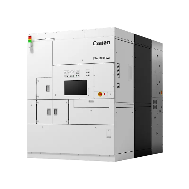

Overview
FPA-3030iWa processes ≤ 200 mm diameter substrates
- FPA-3030iWa
can be configured to handle substrate diameters from 50 mm (2 inch) to 200
mm (8 inch) to support a variety of different wafer materials
- Large
exposure field minimizes exposure stitching for large device production
Supports a wide range of manufacturing processes
- 52
x 52 mm wide-field projection lens with a variable numerical aperture (NA)
ranging from 0.16 to 0.24
- Large
depth of focus (DOF) allows uniformity patterning of submicron features
Compatible with a variety of different wafer sizes and materials
- Wafer
feeder options support warped and transparent substrate processes using
sapphire, silicon carbide and gallium nitride wafers
Off-axis alignment scope provides overlay process robustness
- FPA-3030iWa
employs an off-axis alignment scope that measures wafer alignment marks
through an off-axis optical path
- Off-axis
alignment system allows use of a wide range of alignment illumination
wavelengths to help optimize alignment process performance
- Simultaneous X & Y alignment mark measurement is available to increase stepper productivity
