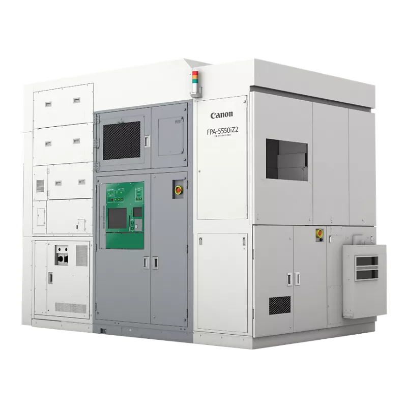

Overview
FPA-5550iZ2
provides high productivity and overlay accuracy.
- FPA-5550iZ2
steppers reduce wafer processing time by optimizing the alignment, exposure and
wafer transfer sequences
- FPA-5550iZ2
steppers are equipped with a Shot Shape Compensator (SSC Unit) to enable shot
shape correction of vertical and horizontal magnification differences and skew
(shot distortion in diagonal orientation) within each exposure field
- Shot
Shape Compensator employs original Canon technology in the projection optical
system that allows improved matching to underlying layers and improved overlay
accuracy
FPA-5550iZ2
steppers provide a variety of solutions for logic / memory / image sensor
fabrication
- Productivity
improvement and Overlay Improvement options to balance throughput and overlay
accuracy are available
- Color filter and other alignment system options established for earlier FPA-5550iZ steppers allow stable operation and flexibility for a variety of processes
