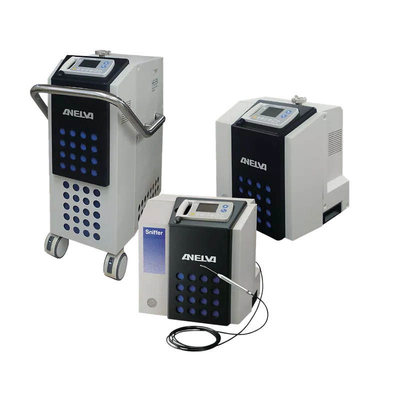

Overview
Features
- Simple operation (startup to measurement with a touch of a button)
- Industry leading sensitivity (10-12 Pa.m3/s), stability, and response
- Use of long life tungsten filament to enable long term high-sensitivity measurement
- Portable - Equipped with large casters and handle making it suitable for field maintenance use
- Durable robust design enabling use in application where high usage is needed
Main Unit Specs
| Type | M-212LD | M-212LD-D | M-222LD | M-222LD-D | M-232LD | |
| features | Compact | Compact & dry pump |
High power | High power & dry pump |
Sniffer | |
| Quantitative measurement range (Pa・m3/sec) |
10-12 to 10-3 | 10-6 to 10-1 (10-2 to 105 ppm) |
| Inlet port exhaust speed (He)(L/sec) |
Gross Mode | 0.5 | - | 1.8 | 2.0 | Probe suction speed 0.3Pa・m3/sec |
| Middle Mode | 2.0 | 1.0(Middle2) 4.0(Middle1) |
2.0 | 2.0 | ||
| Fine Mode | - | 7.0 | - | - | ||
| Inlet port size | NW25(ISO) | Sniffer Probe | ||||
| Main pump | Type | Turbo molecular pump | ||||
| Pumping speed (L/sec) |
50 | 70L/sec | 50L/sec | |||
| Roughing pump | Type | Rotary pump | Diaphragm pump | Rotary pump | Scroll type dry pump |
Rotary pump |
| Pumping speed (L/min) |
30 | 15 | 236 | 250 | 30 + Diaphragm pump |
| External communication interface | RS-232C Analog output (2 points)・Standard I/O |
| Display | 4.1 inch Color LCD | |||||
| Sniffer probe | Option (Model:981-9371) |
Option (please require to contact) |
Standard | ||
| Electric power | 100-120VAC, 8A | 100-120VAC, 6.3A | 100VAC, 15A | 100-120VAC, 15A 200-240VAC, 10A |
100-120VAC, 8A | |
| Dimensions (W×H×D)(mm) |
435×487×364 | 462×867×715 | 435×470×363 | |||
| Weight(kg) | 42 | 39 | 75 | 42 | ||
| Type | M-222LD-H | M-222LD-D-H | M-222LD-D-H500 | |||
| features | High sensitivity, & High power |
High sensitivity, High power, & dry pump |
High power & dry pump of 500L |
10-13 to 10-3 | 10-12 to 10-3 | ||||
Gross Mode | 1.8 | 2.0 | 2.0 | ||
| Middle Mode | 4.0 | 4.0 | 4.0 | |||
| Fine Mode | 7.0 | 7.0 | 7.0 | |||
| Inlet port size | NW25(ISO) | |||||
70 | |||||
| Roughing pump | Type | Rotary pump | Scroll type dry pump |
Multi stage roots type dry pump |
236 | 250 | 500 | |||
| Electric power | 100VAC, 15A | 100-120VAC, 15A 200-240VAC, 10A |
100-120VAC, 8A | |||
462×867×715 | |||||
| Weight(kg) | 75 | |||||
