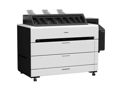

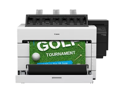

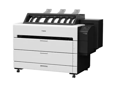

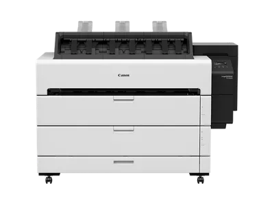

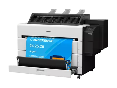

imagePROGRAF TZ-32000
As low as $0.00
Out Of Stock
  • LUCIA TD 5-Color Pigment Ink System
  • Up to 4 D-Size Prints per minute*
  • Intelligent Media Handling
  • Integrated Top Output Stacker
  • Standard Dual Roll Configuration With Hot Swap Media Capability
*All speeds measured using plain paper, Fast Q5 mode. Print speed is based on internal testing. Print speed may vary depending on the number of copies selected, as well as on the settings for size, type, and orientation of paper.

Overview
This 36" large-format printer is designed for optimal production, efficiency, and versatility, the imagePROGRAF TZ large-format printer is a cutting-edge hybrid solution. It stands out in the production aqueous inkjet market with its capability to print a wide range of output from monochrome line drawings to vibrant full-color posters on various media substrates.
