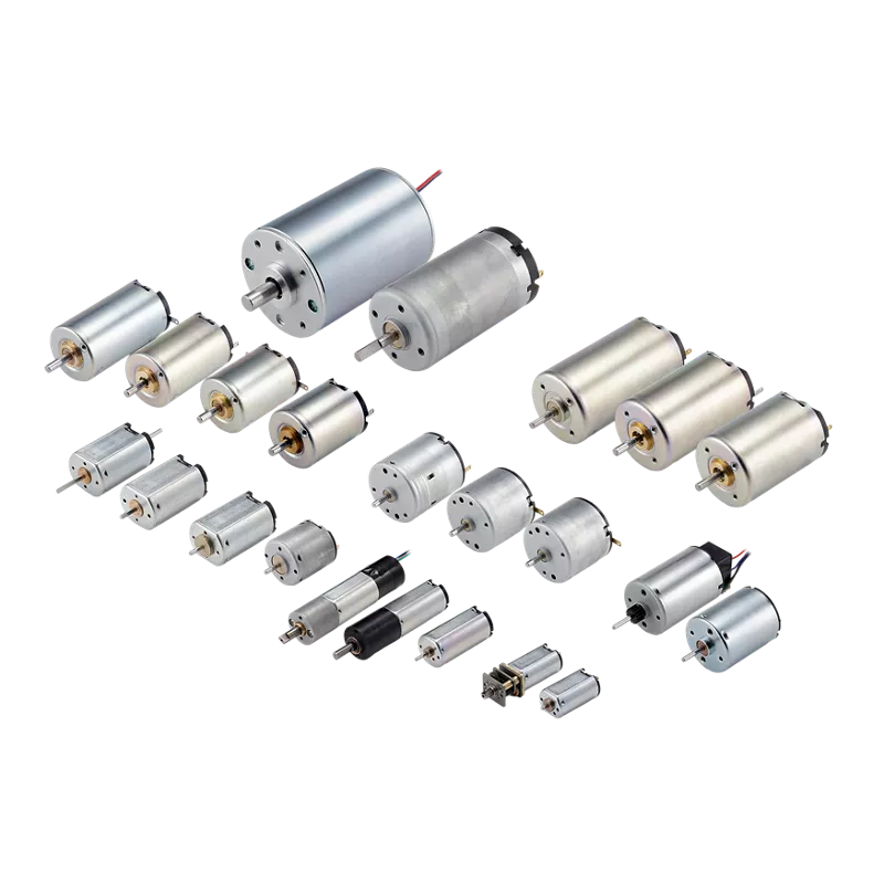

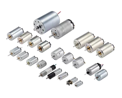

Iron Cored Motors
As low as $0.00
Out Of Stock
  • Size range: φ22 - 42mm
  • Engineered and manufactured in Japan
  • Designed for dependable operation and long‑term reliability
  • Options: gears, encoders, lead wires, etc.
  • Motor characteristics can be adjusted to customer requirements
