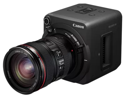

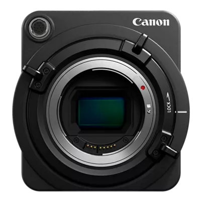

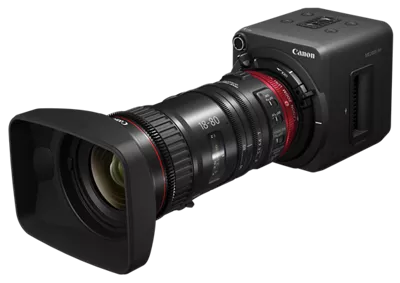

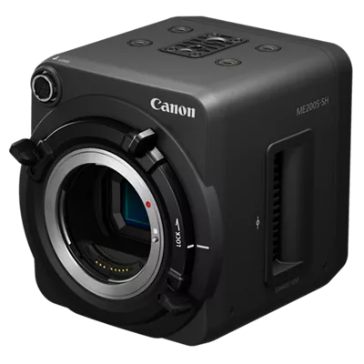

Overview
The ME200S-SH Multi-Purpose camera delivers the high quality video and versatility needed for a wide range of professional video production applications. The camera's modular design allows you to connect only the components you need, depending on how you want to use the camera- making it easy to incorporate into a variety of camera systems. An HDMI terminal allows for connection to compatible third party external displays, and 3G/HD-SDI terminals allow for connection to compatible third party external displays and recording devices. The camera is compact (4.0" W x 4.6" H x 4.4" D) and lightweight (2.2 lbs), helping to broaden the range of applications.
Featuring the same Super 35mm CMOS sensor used in our Cinema EOS cameras, the ME200S-SH camera delivers an outstanding balance of image quality and sensitivity. Capable of 204,000 ISO, the camera performs extremely well in low-light conditions. The camera's Dual Pixel CMOS AF (Auto-Focus) technology works to maintain focus of moving subjects, and it's rugged construction make it able to withstand use in harsh environments. In addition, the camera can be controlled using Canon's optional RC-V100 remote control, further expanding the potential uses of the camera.
Offering high quality video and flexible expandability, the affordable ME200S-SH Multi-Purpose camera can be ideal for television, nature and wildlife, documentary production, security and law enforcement.
