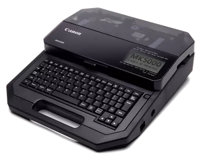

The Canon MK5000 cable & wire marker printer is a lightweight and portable printer designed for productivity. With fast print speeds and broad media support, the printer is designed to easily produces tube, tape, and plate strip cable markers quickly and efficiently. The MK5000 also includes dual power supply support, which allows for increased flexibility and ease of use at work site locations.
