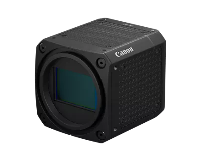

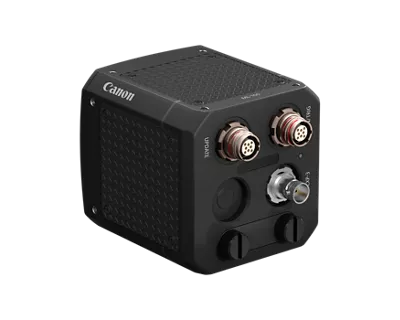

Get Higher Sensitivity and Image Quality With the ML-100
The Canon ML100 provides you with high sensitivity, top-of-the-line image quality, and reduced form factor. However, despite its smaller size, the camera’s functionality remains exceptionally robust. Select either the EF or M58 lens mount. This high-end, industry-focused camera comes standard with a CoaXPress interface.
Extremely Compact Without Sacrificing Functionality
Compared to the ME20F-SH, the ML-100 is 50 percent smaller, with a 76 x 76 x 112 mm compact form factor. This camera produces 2152 x 1272 video at 73 fps (12-bit approx.), or 97 fps (8-bit approx.)*. It offers a 35mm full-frame CMOS sensor, minimum illumination of 0.0005 lux (or less), over 2.7 million pixels, and meets MIL Standard equivalents.

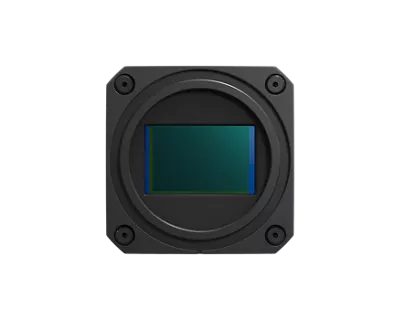

Exceptional Low Light Sensor
The ML-100 Machine Vision Camera features a Canon full frame 35mm CMOS sensor with an equivalent sensitivity in excess of 4,000,000 ISO.
This innovative 35mm full frame CMOS sensor has photosites measuring 19 micrometers square. The large photosites allow for exceptional low light performance, with a minimum subject illumination of 0.0005 or below (at maximum 75 dB gain).

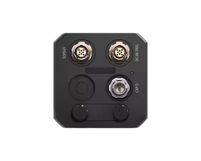

ML-100 Inputs and Outputs

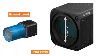

M58 Mount Option
M58 Inner Thread (for lenses)
A variety of lenses can be attached using adapters. No electrical interface for lens control.
M65 External Thread (for accessories)
The outer threads around the mount are provided for use with accessories such as the example below.

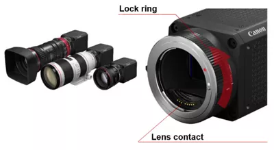

EF Mount Option
Lock Ring
The EF mount's lock ring makes attaching and detaching lenses easier even when multiple accessories are attached.
Lens Contact
This enables lens data transmission such as One Shot AF* through EF Lenses.
Supported Lenses (Canon)
  • EF Lenses
  • EF Cinema Lenses (Excluding Cine-Servo lenses)

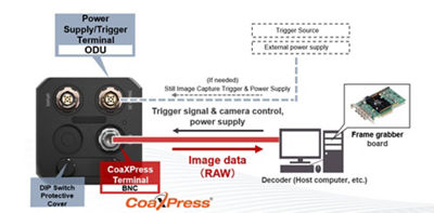

ML100 CoaXPress System Example
ML-100 CoaXPress Example

XLR Power + GPIO Cable
15' Cable for ML100 XLR Power and DB9 GPIO (Required XLR Power Supply not included)
3976V618
XLR Power Cable
15' Cable for ML100/ML105 XLR Power (required XLR Power Supply not included)
