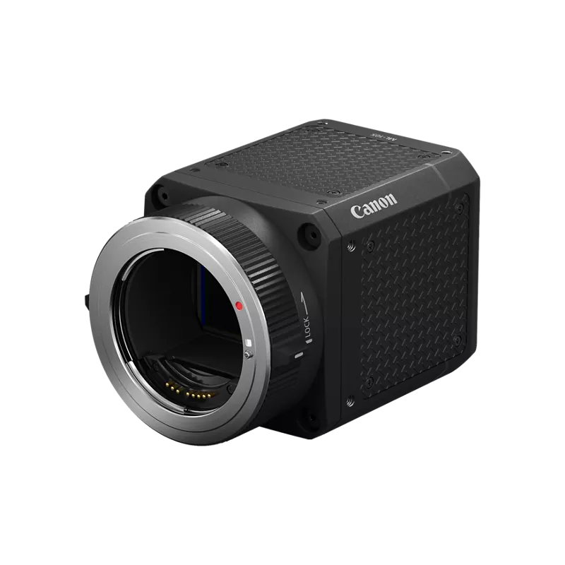

The Canon ML-105 comes equipped with either the EF or M58 lens mount paired with an SDI interface to produce this video application-focused camera. This camera offers high sensitivity, high image quality, and reduced form factor while remaining extremely robust.
Extremely Compact Without Sacrificing Functionality
With a 35mm full-frame CMOS sensor, DIGIC DV4 processor, minimum illumination of 0.0005 lux (or less), and over two million pixels, the ML-105 delivers 1920 x 1080 video. Despite offering all these features, the ML-105 is 50% smaller (than ME20F-SH) with a compact form factor of 76 x 76 x 83 mm. While extremely compact, the ML-105 is still very robust meeting MIL standard equivalents.

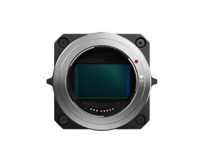

Exceptional Low Light Sensor
The ML-105 Machine Vision Camera features a Canon full frame 35mm CMOS sensor with an equivalent sensitivity in excess of 4,000,000 ISO.
This innovative 35mm full frame CMOS sensor has photosites measuring 19 micrometers square. The large photosites allow for exceptional low light performance, with a minimum subject illumination of 0.0005 or below (at maximum 75 dB gain).

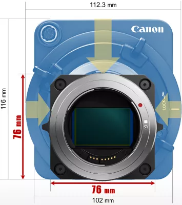

Size Reduction
The ML-105 comes in a box-style design which allows the camera to be easily configured with a wide range of system devices. The ML-105 is more than 50% smaller while maintaining the sensitivity performance of the ME20F-SH. Its modularity allows it to be used on multi-sensor optical systems, surveillance systems for defense, systems for research and surveying, and more.
ML-105 Size Comparison to ME20F-SH

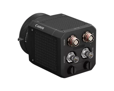

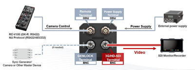

SDI Output
3G/HD-SDI Terminal (BNC)
  • 1920 x 1080
  • YCC 4:2:2 10 bit output (8 bit effective)
  • 59.94P/i, 50P/i
  • GenLock compatible
ML-105 Inputs and Outputs

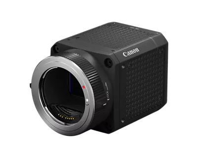

EF Mount Option
Lock Ring
The EF mount's lock ring makes attaching and detaching lenses easier even when multiple accessories are attached.
Lens Contact
This enables lens data transmission such as One Shot AF* through EF Lenses.
Supported Lenses (Canon)
  • EF Lenses
  • EF Cinema Lenses (Excluding Cine-Servo lenses)
ML-105 EF Mount Option
