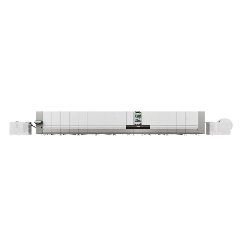

ProStream 3000 Series
As low as $0.00
Out Of Stock
  • Printing Speed: Up to 525 ft/min
  • Print Resolution: up to 1200 X 1200 native dpi
  • Web Width: 22 inches
  • Printable Area: 21.89 inches
  • Paper Weight: up to 300 gsm
  • Substrates: Offset coated gloss, silk, matte, uncoated, and inkjet-optimized
  • In-line Quality Control
  • Advanced Floatation Drying System
  • Fills the gap between Toner and Offset
  • Quality, productivity, versatility
  • Professional, attention grabbing prints
Show more
Overview
Built on the Established ProStream Technology Platform
The new ProStream 3000 series delivers consistent offset print quality at industrial speed on a wide selection of substrates including heavyweight paper, enabling ultra-fast digital production of a broader range of commercial print jobs.
With the ProStream™ Series, you can benefit from broad substrate support and format versatility up to B2 sheet size, plus support for coated or uncoated media. This continuous feed press fits seamlessly into your workflows, allowing easy integration into existing PDF workflows, IPDS and PDF DFE, plus an intuitive, modern user interface. You can now enter new markets by offering outstanding quality, relevant content and short turn-around times for promotional and graphical applications - with the versatility of digital variable data printing.
The extended media capability makes it even easier for print businesses – including general commercial and online printers, direct mail printers, book producers and photo specialty printers – to migrate high-volume, high-value work from offset to digital inkjet and print media like 7pt at full machine speed. With the ProStream, customers can recognize the full end-to-end productivity benefits of inkjet production across the majority of applications, from direct mail and books, to postcards, posters and calendars.
 ColorStream 8000 series
Renowned High Quality
The ProStream 3000 produces renowned high quality on web widths of up to 22 inches and page lengths up to 60 inches up to 525ft per minute, based on the media being used. The new ProStream series can print up to to 62 million US letter pages on a wide range of substrates and weights, including standard offset coated, uncoated and inkjet-optimized papers up to 300gsm, without the need to slow down significantly for heavier media weights.
Main Unit Specs
PRODUCTIVITY
Print Speed
Up to 525 ft/min
Configuration
I-Twin (duplex/perfecting) four color
Throughput Per Hour
13,560 B2 (B2 size is equal to 19.7” x 27.8”) sheets or 137,460 letter impressions
Max. Effective Monthly Duty Cycle
8.2 Mil B2 sheets or 83 Mil letter impressions
TECHNOLOGY
Print Head Technology
Canon DigiDot piezoelectric drop-on-demand
Resolution
Up to 1200 x 1200 dpi (131 and 262 ft/min), 1200 x 720 (at 436 ft/min), 1200 x 600 (at 525 ft/min)
Digidot Technology
Multilevel drop size modulation
Ink Set
ColorGrip conditioning fluid, polymer pigment ink set CMYK with InkSafe technology
Inline Quality Control
Automatic continuous quality control with high-speed camera system
Smart Colorgrip
Operator can control the amount color grip in white areas of the page
PAPER & PRINT IMAGE
Web Width
11.5 – 22”
Maximum Physical Print Width
21.89”
Substrates
Offset coated gloss, matte, silk, dull, uncoated, inkjet, light-weight coated
Paper Weight(1)
28 – 300 GSM
Paper Transport
Tight web, pinless, automatic tension control
PHYSICAL DATA TWIN ROLL-TO-ROLL(2)
Length × Width
46.7’ x 13.3’
Height
6.6'
Weight
33,753 lbs.
POWER CONNECTION PRINTER
Connection
Tower 1: 400 V / 39 kW 56 A; 400V/125kW 180 A
Tower 2: 400 V / 39 kW 56 A; 400V/125kW 180 A
Controller 400V/16 A
ENVIRONMENTAL REQUIREMENTS
Temperature
68 - 80 °F (20 – 26 °C)
Humidity
40 - 60%
Operating Noise
Maximum 80 dB
WORKFLOW
Logical Page Length
6 – 60”; dynamically variable
Controller
SRA MP controller with latest Adobe APPE
Printer Data Format(3)
PDF (PDF/X, PDF/VT), AFP/IPDS (IS/3)
Front End Print Manager
PRISMAproduction PDF Advantage or PRISMAproduction output management system
Operating
Touchscreen user interface
Connectivity
10 Gigabit Ethernet (copper, optic MMF/SR, optic SMF/LR)
Pre- and Post-Processing(4)
Inline or offline; barcode controlled
OPTIONS
Edgenhance
High detail sharpness with enhanced rasterizing architecture
Light Weight Kit
This option will provide the ability to run 28 GSM media
Narrow Web
Allows the usage of paper widths smaller than the standard minimum width of 16 inches to 11.5
* B2 size is equal to 19.7” x 27.8”
