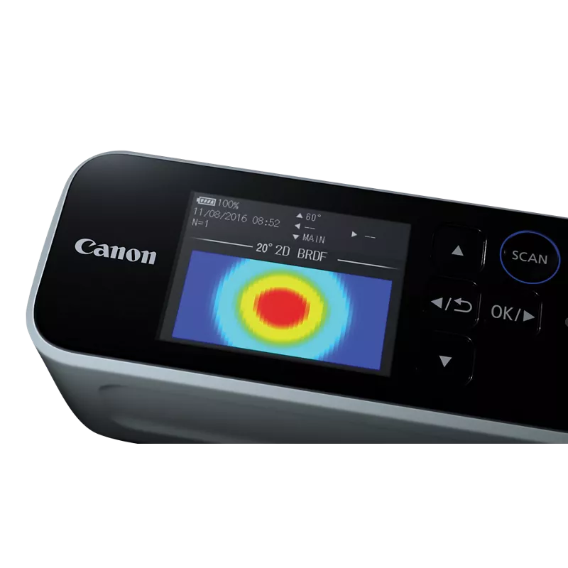

RA-532H
One shot analysis of all 4 surface conditions; Gloss, Haze, Image Clarity, and BRDF*1
Scattering, Canon’s proprietary index, quantifying the diffusion of BRDF for specular components
Simultaneous measurement and output of 3 lighting angles of 20°, 60°, and 85°
2-D BRDF measurement suited for evaluation of matte and textured surfaces
Monitoring camera to check measurement area for each lighting angle

Surface Reflectance Analyzer RA-532H is a handy measuring device to comprehensively evaluate surface conditions of objects. It covers a wide range of measurement methods from standard compliant Gloss, Haze, Image Clarity (IC) to 2-D BRDF (Bidirectional Reflectance Distribution Function) measurements. Additionally, Scattering Index, Canon’s proprietary index, is developed to overcome the shortage of both IC and DOI (Distinctiveness of Image) when evaluating matte and textured surfaces as well as orange peeled surface.
