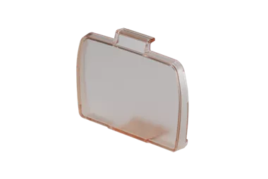

• Colors may vary between E-TTL autoflash and manual flash under the following conditions:
* When the color temperature of the Speedlite light differs greatly from that of ambient lighting and flash exposure compensation is set toward the negative end.
* When E-TTL balance is set to (Ambience priority).
• Differences in colors between E-TTL autoflash and manual flash may be reduced by taking one of the follow steps:
* Using the provided color filter.
* Setting white balance to an option other than AWB.
