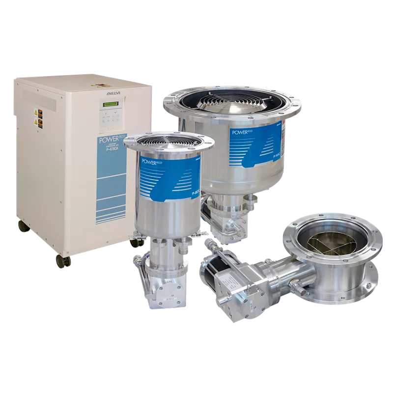

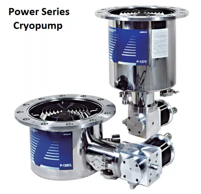

POWER Series Cryopump
- High performance cryopump having 8" to 12" intake diameter
- Suitable for applications such as semiconductor manufacturing equipment, electronic component manufacturing equipment, vacuum evaporation systems, vacuum furnaces, space chambers, accelerators, and various high vacuum equipment

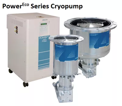

POWER Eco Series Cryopump
- High performance energy-saving cryopump with 8" to 22" intake diameter

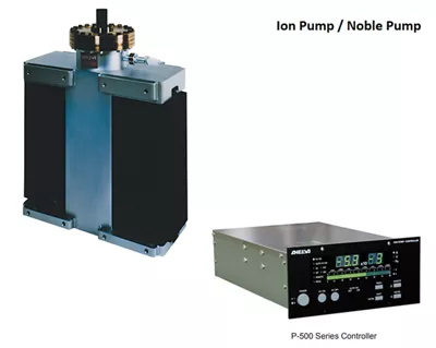

Ion Pump/Noble Pump
- Ion pump/noble pump is an ultra-high vacuum pump, which utilizes the gas adsorption properties of the cathode material (Ti)
- Useful in applications such as electron microscopes, surface analyzers, particle accelerators, nuclear fusion experiment apparatus, space environmental testing equipment, and vacuum retention pump for electron tubes

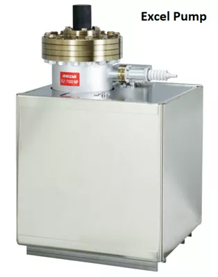

Excel Pump
- Excel pump is a small, light weight pump developed based on the ion pump technology

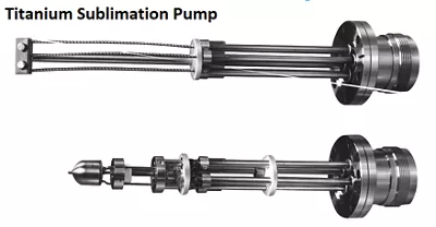

Titanium Sublimation Pump/Tie-back Pump
- Titanium sublimation pump and tie-back pump are getter pumps that heat and sublimate titanium to form a titanium film (getter surface) on the surrounding walls and use the getter effect to absorb and discharge air
- Effective in reducing the pumping time and decreasing the ultimate pressure and increasing the pumping capacity of your current vacuum pump systems (ion pump, cryopump, turbomolecular pump)

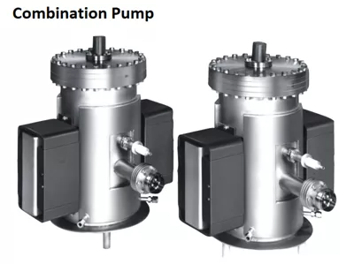

Combination Pump
- Combination pump combines the titanium sublimation pump with the triode ion pump (noble pump) to economically increase pumping speed while maintaining the feature of ion pump
- Suitable for deposition equipment, electron microscopes, mass spectrometers, vacuum furnaces, various analysis equipment, pumping equipment and other ultra-high vacuum systems with large gas discharge

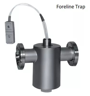

Foreline Trap
- Using foreline trap prevents back streaming of oil vapor from oil rotary vacuum pump and the resulting contamination inside vacuum equipment
- Useful in applications where oil rotary vacuum pump is used
Main Unit Specs
| Pump Type | P-080C | P-081C | P-081CL | P-082C | P-083C | P-100CL | P-101C | P-101CL | Remarks | |
| Diameter | 8inch | 8inch | 8inch | 8inch | 8inch | 10inch | 10inch | 10inch | ||
| Shape | Vertical | Vertical | Horizontal | Vertical | Vertical | Horizontal | Vertical | Horizontal | ||
| Pumping speed (L/S) |
Nitrogen | 1,500 | 1,500 | 1,500 | 1,500 | 1,500 | 2,400 | 2,400 | 2,400 | |
| Argon | 1,300 | 1,300 | 1,300 | 1,300 | 1,300 | 2,000 | 2,000 | 2,000 | ||
| Hydrogen | 1,000 | 2,500 | 2,200 | 1,000 | 1,000 | 3,000 | 3,800 | 3,700 | ||
| Water | 4,000 | 4,000 | 4,000 | 4,000 | 4,000 | 6,400 | 6,400 | 6,400 | ||
| Maximum pumping flow(Pa·m3/s) |
1.5 | 1.2 | 1.2 | 1.5 | 1.5 | 1.0 | 1.0 | 1.0 | ||
| Maximum gas instantaneous tolerance(Pa·m3) |
18.0 | 18.0 | 18.0 | 18.0 | 18.0 | 18.0 | 18.0 | 18.0 | ||
| Startup time(min) | 45 | 50 | 65 | 45 | 50 | 80 | 70 | 80 | *1 | |
| Regeneration (heat-up) time(min) |
30 | 30 | 30 | 30 | 35 | 40 | 35 | 45 | *1 | |
| Startup regeneration time(min) |
75+α | 80+α | 95+α | 75+α | 85+α | 120+α | 105+α | 125+α | *1 | |
| Pumping capacity (Pa·m3) |
Argon | 80,000 | 80,000 | 80,000 | 150,000 | 190,000 | 140,000 | 160,000 | 140,000 | *2 |
| Hydrogen | 1,300 | 1,800 | 1,600 | 1,300 | 1,300 | 1,300 | 2,000 | 1,800 | ||
| Ultimate temperature(K) |
15 or less | |||||||||
| Ultimate pressure(Pa) |
Approx. 10-7 | |||||||||
| Maximum heating temperature(℃) |
70 | |||||||||
| Ambient temperature range(℃) |
10 to 35 | |||||||||
| Recommended maintenance interval(h) |
Within 16,000h | |||||||||
| Weight (kg) | 22 | 22 | 22 | 23 | 24 | 25 | 24 | 25 | ||

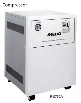

| Number of operable units |
P-421CA | 1 | 1 | 1 | 1 | 1 | 1 | 1 | 1 | *3 |
| P-875CA | 3 | 3 | 3 | 3 | 3 | 3 | 3 | 3 | *3 | |
