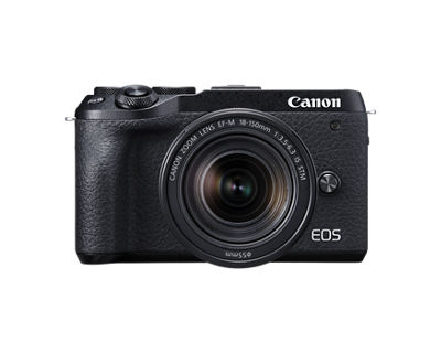

Type Digital single-lens non-reflex AF/AE camera with built-in flash
Recording Media SD, SDHC and SDXC Memory Cards
SD speed class compatibility.
UHS speed class compatibility.
High-speed writing is supported when a UHS-I or UHS-II-compatible SD card is used.
Multimedia cards (MMC) cannot be used (card error will be displayed).
Image Format Approx. 22.3 x 14.8mm (APS-C Size)
Compatible Lenses Canon EF-M lens (when using EF-M Mount Adapter: EF/EF-S lens group)
Equivalent to approximately 1.6x the focal length indicated on a mounted lens
Type CMOS sensor
Pixels Effective pixels: Approx. 32.5 Megapixels
Total pixels: Approx. 34.4 Megapixels
* Pixels may decrease due to image processing.
Pixel Unit Square pixel approx. 3.2 μm
Aspect Ratio 3:2
Dust Removal Feature (1) Self Cleaning Sensor Unit
  • Removes dust adhering to the low-pass filter.
  • Self-cleaning can be done automatically when the power is turned on or off.
    Manual cleaning also possible.
(2) Dust Delete Data acquisition and appending
  • The coordinates of the dust adhering to the low-pass filter are detected by a test shot and appended to subsequent images.
  • The dust coordinate data appended to the image is used by the EOS software to automatically erase the dust spots.
Recording Format Design Rule for Camera File System 2.0 and EXIF 2.31*
* Supports time difference information.
Image JPEG, RAW (CR3 a Canon 14-bit RAW format), C-RAW.
