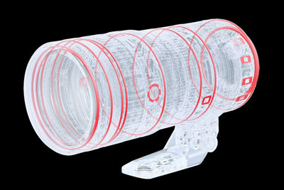

Weatherproof
Dust- and moisture-resistant construction performs to spec in even the most rugged shooting conditions

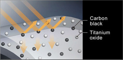

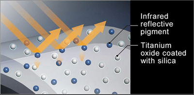

Heat Shield Coating
Bringing the “white barrel” into fashion

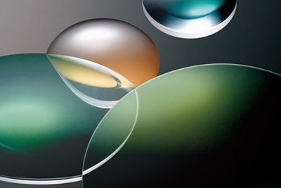

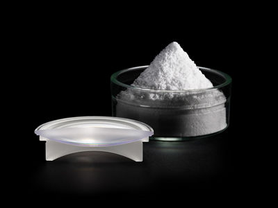

Fluorite

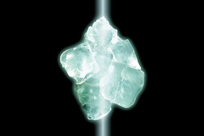

Fluorite is an amazing mineral that emits and disperses light when heated to high temperatures. The stone was named “fluorite” for its beauty and fluorescent properties. Calcium fluoride (CaF2) is a naturally occurring crystalline mineral. When made synthetically, calcium fluoride crystals have outstanding optical characteristics including low dispersion, an extremely low refractive index, and excellent transmittance of infrared and ultraviolet light. Most importantly, fluorite can produce clear, detailed image delineation that conventional optical glass simply cannot match. Canon set out to leverage these properties when it inaugurated the “F” Program, to develop high-performance camera lenses incorporating fluorite.
Fluorite had been a focus of attention for centuries. In the 1800s, natural calcium fluoride crystals were already being used as objective lenses in microscopes. Later, attempts were made to produce synthetic fluorite crystals for use as lenses in larger instruments such as telescopes. However, technical hurdles were high and many believed it would be impossible to use fluorite in standard lenses. This challenge failed to quell the enthusiasm of Canon researchers, as they took up the task of developing fluorite into a viable optical material for use in high-performance lenses.
Differences in the convergence point of wavelengths of light affect the sharpness of an image transmitted through a lens, and appear in photographs as color bleed. This is technically known as “chromatic aberration.” The key to designing a high-performance lens is to find configurations that correct chromatic aberration. Typically, a low-dispersion convex lens and a high-dispersion concave lens are used in combination to standardize the direction of light waves and align them all at a single convergence point.
However, careful examination of the area surrounding the convergence point of such a lens will reveal a residual aberration in the focal point for green wavelengths, which disperse between the red and blue. This slight residual chromatic aberration is known as secondary chromatic aberration or secondary spectrum aberration. Fluorite is characterized by extremely low dispersion, and unlike optical glass, its dispersion is exceptional. Therefore, it can play a significant role in eliminating this persistent secondary spectrum aberration. When a convex fluorite lens is used, to reduce chromatic aberration in the secondary spectrum, the red, green and blue focal points converge almost perfectly, at a single point. In 1968, two years after the launch of the F Program, Canon researchers successfully produced a synthetic fluorite crystal.
But numerous hurdles remained before fluorite could be used in a camera lens. Because fluorite cannot be ground in the same manner as optical glass due to its fragility, Canon drew upon its legacy of lens grinding technology to develop a special technique for handling fluorite. This grinding process takes four times longer than standard techniques, and afterward, each lens needed to be washed by hand.
In 1969, Canon finally succeeded in producing a lens from fluorite — the FL-F300mm f/5.6 was the world’s first* camera lens to incorporate a fluorite element. Because longer focal length makes telephoto lenses more susceptible to the effects of secondary spectrum aberration, fluorite made a significant contribution to the performance of this lens. Today, the Canon L-series of fluorite-based super-telephoto lenses, characterized by refined delineation and exceptional high contrast, have earned a loyal following among photographers all over the world.
* Refers to lenses for general consumer-use, interchangeable-lens cameras.

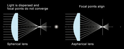

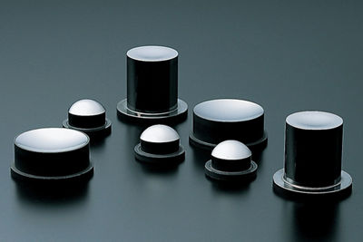

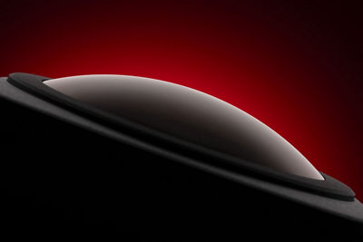

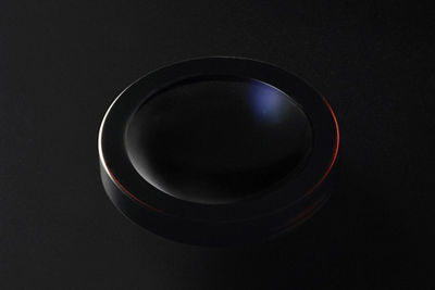

Aspherical Lenses
Canon’s L-series lenses owe their high performance and crisp image resolution to an advance in optical technology that offers truly revolutionary optical characteristics — the aspherical lens. Aspherical lenses offer impressive sharpness and vivid detail that it almost seems like a veil has been lifted to reveal the visible world behind the lens. For years, aspherical lenses were only a dream for optical engineers, since their actual fabrication is so difficult. Aspherical lenses differ from conventional photo lenses — which are spherical — as a part of the spherical surface of the lens element has to be cut away at the optical axis. However, these lenses faced theoretical limitations due to their inability to converge parallel rays of light at the same focal point. The solution was to fabricate an aspherical lens with an ideal curvature, which converges parallel rays at a single focal point.
In some aspherical lens designs, the degree of asphericity is very slight. To the naked eye, it appears identical to a spherical lens. The degree of curvature is so slight that precision processing tolerances must be calculated to within 0.1 micron (1/10,000th of a millimeter). Though certain issues relating to mass production had not been completely resolved, at the time, Canon introduced the FD55mm f/l.2 AL in 1971. It was the world’s first SLR camera lens (without mirror-lock mechanism) to incorporate a ground aspherical lens element. The strong reception this lens received prompted Canon to increase production volume and accelerate aspherical lens research. Just two years later the company was able to introduce that the world’s first nanometer-class mass-production equipment (with tolerances of less than one-millionth of a millimeter).
The lenses are polished precisely to a precision of just 0.02 micrometers, which is just 1/32 the height of a wavelength of visible light. This exacting precision ensures that the lenses will deliver high optical performance that one can only find with the L-Series.
Aspherical lens manufacturing technology continued to evolve. In the 1980s, research and development of large-diameter glass-molded (GMo) aspherical lenses began, and in 1985 these elements were successfully put to practical use. Glass molding technology uses high-temperature melted glass and aspherical, high-precision metal molds, to achieve superior surface tolerances. In 2007 the technology was used to make the first concave aspherical lens. The same technology has been used in many of today’s RF L-series lenses.
One Canon aspherical lens that satisfies a variety of needs is the replica aspherical lens, which was developed for the EF lens series in 1990 and is characterized by a high degree of design freedom in terms of the size, and the type of material used to make the spherical base lens element. In the RF lens series, the RF24-105mm F2.8 L IS USM Z also uses a replica aspherical lens. Improvements in the manufacturing process have given replica aspherical lenses a surface precision superior to that of EF lenses. In addition to offering greater freedom in optical design, the size of the new lens has been reduced while providing a focal length of 24mm-105mm with consistent performance at a bright aperture of f/2.8.
High-temperature melted glass and aspherical lenses

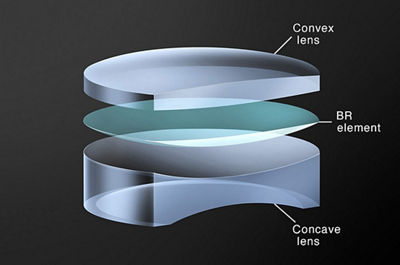

BR Lens
By developing fluorite and UD lenses, Canon has been able to suppress the chromatic aberration that was typically found when using conventional lenses. Previous technology was not able to eliminate chromatic aberration and reduce size and weight at the same time, particularly in the case of wide-aperture lenses with low f/ values. Chromatic aberration is caused by the dispersion characteristics of light. Ideally, all of the light passing through a lens should converge on a single point on the focal plane. Unfortunately, differences in the refractive index of different wavelengths inevitably cause some dispersion. This is the real cause of chromatic aberration (color bleeding). Wavelengths in the blue range of the spectrum are particularly difficult to correct, and cannot be fully resolved merely by combining concave and convex lenses. Inevitably, this creates some chromatic aberration.
To solve the problem, Canon developed the "BR Lens", a composite lens in which BR (Blue Spectrum Refractive Optics) optical elements with anomalous dispersion characteristics that greatly refract blue (short wavelength range) light are sandwiched between concave and convex glass lenses. BR lenses allow for greater freedom in lens design, because the other lens elements can be arranged in ways that may produce considerable chromatic aberration, but the blue wavelengths can then be largely corrected by the inclusion of the BR lens element. By developing new types of lens materials in this way, Canon is introducing lenses that can offer unique optical characteristics, while also improving performance and reducing size.

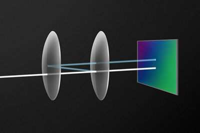

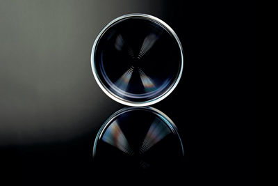

DO Lenses

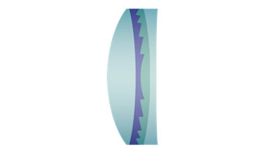

The introduction of the EF400mm f/4 DO IS USM lens, in 2001, marked the debut of a new technology that would greatly impact super-telephoto lenses. It is the first lens to incorporate a Diffractive Optical (DO) lens group — a proprietary Canon optical technology that allows the size and weight of the 400mm f/4 lens to be reduced, while maintaining the same high performance.
Light has the feature of bending around the edges of obstacles. This physical phenomenon is called “diffraction”. The diffraction phenomenon is known to appear in photographic lenses, particularly when the lens is set to a small aperture. This phenomenon usually degrades image quality. However, Canon discovered a way to take advantage of this feature of light, with the DO lens. The direction of light is regulated using an extremely fine, saw-tooth-shaped grid on the surface of the lens that is aligned in concentric circles. This structure is effective in correcting chromatic aberration.
While general refractive lenses create images that split the spectrum in the order of blue > green > red, DO lenses do the exact opposite, forming images that refract the spectrum in the order of red > green > blue. By combining these two types of lenses, it is possible to cancel and correct chromatic aberration. Furthermore, this makes it possible to reduce the overall length and weight of the lens significantly, compared to conventional optical system designs that use only refractive lenses. This is a triumph of flexible thinking, whereby Canon leveraged the “negative” characteristics of diffraction in order to achieve a technological breakthrough.
DO lenses have evolved further, and the technology has been incorporated in the RF lens lineup: the RF600mm F11 IS STM and RF800mm F11 IS STM use a gapless double-layer Diffractive Optical element. The cost has also been reduced, thanks to the development of a special resin material to provide the adhesion between layers.
Close-coupled double-layer Diffractive Optical element
(RF600mm F11 IS STM)

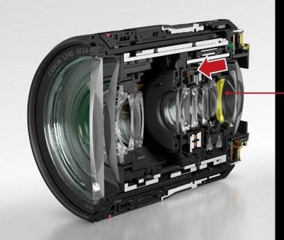

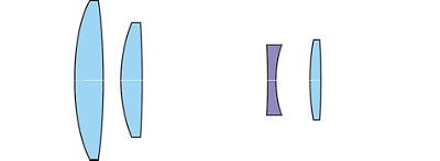

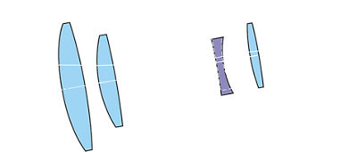

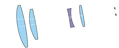

Floating System
Nowadays, optical technology has reached a level where it is possible to produce high-quality images at any shooting distance. Generally speaking, when you use an RF or EF lens, it is unlikely that you will notice any difference in the imaging performance regardless of the shooting distance. This is because the design of most lenses today includes elements that correct for various types of aberration, based on the range of shooting distances at which the lens is most often used. However, when the subject falls outside this “standard range” (particularly when the subject is closer than the distance for which the lens was designed), it is more likely that some sort of aberration will occur.
The degree of performance degradation will depend on the aperture setting, and the type of optical system being used. The shorter the focal length and the larger the aperture, the greater the potential for aberration. Wide-angle lenses, in particular, experience greater image curvature at short distances. If the center of the image is sharp, there will be some blurring at the periphery, while a sharp focus at the periphery will result in blurring at the center of the image. To solve this problem, Canon developed floating mechanism technology that provides ideal aberration correction at all shooting distances.
This minimizes aberration at all shooting distances, delivering excellent imaging performance from close range to infinity. This floating system is used in the EF24mm f/1.4L II USM and other large-aperture wide-angle lenses, as well as the EF180mm f/3.5L Macro USM, allowing them to achieve crisp imaging performance at close range. Large aperture lenses, even those with a near-symmetrical lens structure, tend to experience spherical aberration when used at close range. For this reason, a floating mechanism is used in EF lenses such as the EF50mm f/1.2L USM and EF85mm f/1.2L II USM, and also in RF lenses such as the RF70-200mm F2.8 L IS USM and RF100-500mm F4.5-7.1 L IS USM. Unlike the mechanism used in wide-angle lenses, the rearmost lens element of these lenses is fixed in place, while the floating mechanism allows the other elements to be movable. This helps to ensure excellent imaging performance and minimized lens flare at all shooting distances.

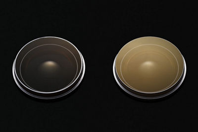

SWC: Subwavelength Structure Coating
Lens surface coatings are thinner than visible wavelengths of light. Canon uses an evaporating deposition method known as “evaporated film coating” to coat the lens surface with an ultra-thin layer that reduces reflection from the lens surface and boosts light penetration, in order to minimize lens flare and ghosting. However, the anti-reflective properties of evaporated film coatings tend to decrease as the incident angle of light entry and exit becomes sharper. Therefore, to improve imaging performance further, it is necessary to find even more effective ways to restrict light reflection. Since evaporated film coating had reached the limits of effectiveness, Canon had reached an impasse in the development of new optical arrays.
The technological breakthrough that took anti-reflective film coatings to the next level is known as Subwavelength Structure Coating (SWC). This technology makes it possible to control lens flare and ghosting even on lens surfaces that previously could not be suppressed with evaporated film coating. The anti-reflective principle underlying SWC is based on continuous variation of the refractive index. Reflections from the lens surface are caused by the differential between the refractive index of glass and that of air. By placing a layer of material with a continuously varying refractive index between the glass and the air, it is possible to smooth the transition of light from air to glass or from glass to air, thus minimizing reflection.
The solution was discovered in nature: The eyes of a fly are covered with minute (nanometer-scale*) convex-concave protuberances. This structure forms a layer with a very low refractive index, effectively preventing reflection. Canon technicians studied this principle in great detail, through extensive trial-and-error experiments, until they finally succeeded in developing a revolutionary coating technology that deposits a layer on the lens surface with nanometer-level structure. This consists of protrusions on the lens surface that are just 200-400nm in size, smaller than visible wavelengths of light (approx. 400-700nm). The layer is deposited evenly across the lens surface with the protrusions exposed to the air. This produces a gradual variation in the refractive index from the tip of the coating to its base, effectively absorbing incident light and guiding it through the lens surface. This revolutionary technology was first used in the EF24mm f/1.4L II USM lens, opening a new frontier in wide-angle lens performance.
* 1nm=1 millionth of a millimeter

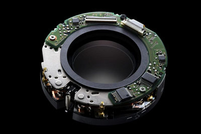

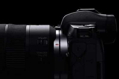

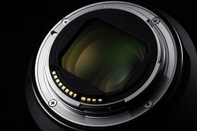

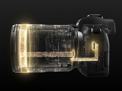

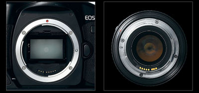

Large-Diameter Fully Electronic Lens Mount
All imaging enthusiasts want their camera to function as if it is an extension of their body. In order to realize this wish, the EF lens adopted an innovative "fully electronic mount" that makes the operations between the body and the lens fully electronic eliminating the need for mechanical connections. When the mount is used, all data transferred between the EF lens and the EOS camera body is handled electronically. Autofocus communication links between the lens, and the body are maintained even when an extender is used, ensuring optimum operability and durability even in the most severe conditions. Canon’s large, 54mm diameter electronic lens mount provided the foundation for the design and production of the world’s brightest 35mm SLR camera lens — the EF50mm f/1.0L USM. This large-aperture lens can achieve fine detail and an attractive background blur (bokeh) even in candlelight, expanding the potential range of photographic expression. The large-diameter electronic lens mount design also facilitates the development of new lenses for the EOS R system, such as single-focal length lenses with large apertures and zoom lenses with higher magnification power.
Electronic lens mount (body side)
Electronic lens mount (lens side)

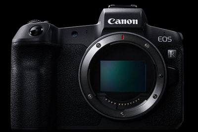

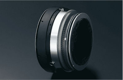

RF Mount
Canon introduced the EOS R System, and the RF mount, in 2018 — just over 30 years after the launch of the EF mount and EOS System. This imaging system marked the start of a new era for Canon, offering greater flexibility and growth potential. Since the objective of the EOS R System was to expand the range of possibilities to support the future needs of both photo and video users, Canon recognized the need for a lens mount with new specifications that would ensure maximum growth potential and optical design flexibility. Canon developed the RF mount as the foundation for the EOS R System, with its main focus to develop a new line of lenses to support an imaging system with the potential to evolve and advance well into future.
The RF mount uses a large, 54mm-inner-diameter barrel and short back focus distance of 20mm to dramatically increase the optical design flexibility and support the development of new and unique lens designs. This mount has the potential to develop large-aperture standard zoom lenses with a maximum f-stop of f/2 such as the RF28-70mm F2 L USM lens — Another major feature of the RF mount and EOS R System is the new 12-pin communication system. It greatly improves communication speed, instantly transmitting large volumes of data between the lens and the camera including information for: focus, zoom, aperture, image stabilization settings, lens aberration, and data for digital lens optimizers (DLO). These features allow the system to achieve outstanding image resolution, and a beautiful bokeh effect with a large fully open aperture. The new control ring developed for the lenses also offer smooth operability. The RF series of lenses realizes new possibilities continuing Canon's pioneering philosophy that the EF-mount series of lenses first pioneered.

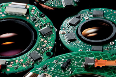

By locating the drive motor inside the lens, Canon is able to fine-tune the motor design to match specific characteristics of the lens. Canon was the first camera manufacturer to successfully use an Ultrasonic Motor (USM) inside the lens to drive autofocus. The ring-type USM is powered by ultrasonic energy oscillations. Therefore, it is virtually silent, consumes little electricity, and is highly responsive to operational commands, making it ideal for controlling AF. First introduced in 1987 with the EF300mm f/2.8L lens, the quiet, high-speed autofocus performance of this USM was hailed as an astonishing achievement. Mass production technology for these motors was perfected in 1990. In subsequent years Canon continued to release sophisticated motors with enhanced performance, including compact, and mass-market models. Canon’s development efforts culminated in a full-time manual-focus system that integrates autofocusing and manual focusing capabilities — a revolutionary feature, particularly for professionals. After the AF has set an approximate focus, the camera operator can fine-tune the focus using the focus ring to achieve a specific, desired focus distance. This full-time MF feature is supported by many L-series and RF mount lenses.

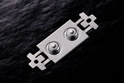

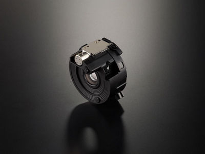

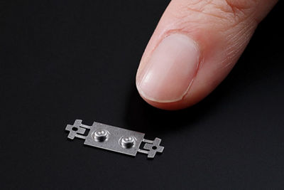

Nano USM
The Nano Ultrasonic Motor (USM) is a compact ultrasonic motor that supports high-speed AF. It was first introduced in 2016, with the EF-S18-135mm f/3.5-5.6 IS USM lens. Using vibrational energy from ultrasonic waves, the motor moves in a straight line along a slider. The position of the focus lens, which is mounted on a rack-like component, can be adjusted along the optical axis with great precision, thus enabling high-speed AF. The very precise micro-movements of this revolutionary AF actuator helps the lens achieve high performance autofocus for both still photography and movie recording. In 2018, a new type of Nano USM was developed for the first time in an L-series lens. The new Nano USM has been miniaturized to fit within a compact lens barrel, to reduce the overall size of the lens as much as possible. It was first introduced on the RF24-105mm F4 L IS USM lens.
The new design of the Nano USM eliminates the spring that formerly applied pressure to a piezoelectric ceramic element on the back end. This structure has been replaced by springs positioned at the four corners of the unit, to significantly reduce thickness while maintaining high torque. The Nano USM is capable of driving a lens at high speed and stopping it with precision, for high-speed AF when taking still photos. When shooting movies, it achieves smooth and near-silent focus for a wide range of expressive purposes.

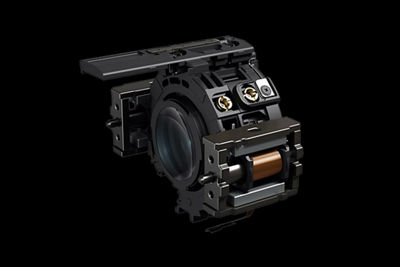

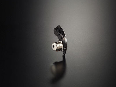

STM
Canon first introduced the Stepping Motor (STM) in the EF40mm F2.8 STM lens. The STM has a smaller actuator than conventional ultrasonic motors (USM). This was a key factor in the development of Canon’s first pancake-type EF lens. The simple mechanical structure of the STM delivers high responsiveness and controllability when starting and stopping. There are two types of STM: a leadscrew type STM that offers exceptionally smooth AF drive, and a gear type STM that minimizes size. The gear-type STM was used in the EF40mm f/2.8 STM lens, and is currently used in a variety of RF-mount lenses. However, the RF10-20mm F4 L IS STM was the first L lens to adopt STM, and for good reason.
The USM has an advantage for lenses with long drive stroke, but the RF10-20mm F4 L IS STM was designed for a shorter stroke. Therefore, developers determined that an STM could be used, and still achieve good performance. The smaller actuator (compared to the USM) provides more freedom in designing the layout of the IS lens group. It is possible to place the image stabilizer (IS) mechanism on the sensor side, thus reducing peripheral blurring. Furthermore, the RF10-20mm F4 L IS STM is the first RF lens featuring an STM that comes with a position sensor. By shortening the start-up time, the overall performance of the lens is comparable to that of the USM.
Gear-Type

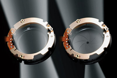

EMD
The Electromagnetic Diaphragm (EMD) is designed to work in tandem with the fully electronic lens mount system to provide high-precision digital aperture control. The EMD combines an aperture-blade unit and a deformable stepping motor. Compared to the system used in conventional cameras, where the aperture blades are opened and closed by mechanical levers in the camera, the new system is able to provide much higher precision control. The aperture can be controlled using an electronic dial on the EOS body, or using an electric pulse signal to set the calculated aperture value. Since no levers are involved, operation is smooth. The introduction of EMD also led to the creation of some very unique lenses, including the world’s first* TS-E lens with automatic diaphragm — an innovative and widely praised lens developed in 1991. In 2021, Canon developed the RF5.2mm F2.8 L DUAL FISHEYE lens, Canon’s first Stereoscopic 3D 180° VR lens equipped with two 5.2mm fisheye lenses. Both the right and left lenses feature separate, synchronized EMDs. Electronic signals can thus control the two EMDs simultaneously, to set the same exposure for both the left and right lenses for easy exposure adjustments.
* Refers to SLR cameras equipped with both tilt and shift functions (as of April 1991).

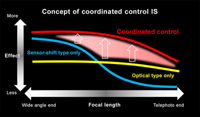

Coordinated Control IS
Canon has been developing and improving in-lens image stabilization (IS) systems for decades. IS functions have been incorporated in many EF and RF lenses, opening up new possibilities in imaging expression for photographers and videographers. The EOS R5 was the first EOS camera to feature an in-body image stabilization mechanism. The coordinated control of the in-lens IS, and the camera’s in-body IS achieves a camera-shake blur correction equivalent of an increase of up to 8.0 stops, in shutter speed. At the time it was released, this was the most effective IS* of any commercial camera. The IS mechanism works as follows: a gyro sensor/accelerometer is installed in both the camera and lens. These sensors, along with the camera’s live-view image, are utilized to detect motion or blurring with high precision, across the entire camera and lens. The camera shake data is then processed at high speed by the image processor and the lens CPU, to reduce detection errors between the camera and the lens. This calculates the appropriate correction ratio, and the camera and lens each make separate optimized corrections to reduce camera-shake blur. The impact that this has on image stabilization not only works for still photos, but for movies as well. This once again demonstrates the technological prowess that Canon has brought to the world of imaging.
* Refers to interchangeable-lens digital cameras available as of July 8, 2020 (both EOS R5 and EOS R6 have coordinated In-Body Image Stabilizer Still Shooting performance effective up to an 8.0-stop increase in shutter speed). According to Canon research.

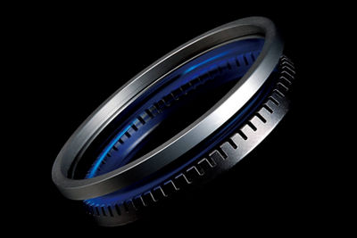

Control Ring
One feature that distinguishes RF lenses from previous Canon lens products is the control ring. The control ring is a feature available on many RF lenses, allowing the user to adjust various settings quickly, utilizing their left hand improving operability.
The RF mount of the EOS R camera body introduced a new 12-pin communication system that improves the coordinated operations between the lens and the camera body. This made it possible to assign various functions to the lens control ring. Aperture, shutter speed, ISO sensitivity, exposure compensation, as well as the AF method, white balance, and picture style can be assigned, selected and adjusted to suit the user's needs. In conjunction with the main dial and quick control dial on the side of the camera body, this new lens control ring offers unprecedented operability. For example, aperture control can be assigned to the lens control ring, while shutter speed and ISO sensitivity can be assigned to the main dial and quick control dial on the camera body. The user can then operate all three controls manually, using the left hand, right index finger, and right thumb, while looking through the viewfinder. The RF control ring is a perfect example of Canon's endless pursuit of the EOS concept of "speed, comfort, and high-quality imaging".

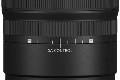

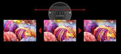

SA Control Ring
Since macro photography involves taking photos at a very close distance to the subject, background blur (bokeh) is achieved by adjusting the aperture, rather than adjusting the distance to the subject. Canon wanted to offer users greater creative freedom in achieving unique bokeh effects when taking macro photos. Canon recognized that the same principle could be applied to adjusting the spherical aberration (SA) as well, and this insight led to the development of the SA control ring. At the time, spherical aberration was generally viewed as a specialty lens feature that only served to decrease overall image quality. Canon overcame this stereotype by creating the means to control spherical aberration with high precision using a dedicated control, allowing users to achieve a softer bokeh, or a harder bokeh effects.
When Canon set out to design a RF Mount successor to the EF 100mm f/2.8L Macro IS USM lens — a favorite of many macro users — the optical design of the RF100mm F2.8 L MACRO IS USM allowed it to be the first Canon lens to adopt the SA control ring. This macro lens design, which offers a maximum magnification ratio of 1.4x, (exceeding the 1.0x magnificaiton performance of the EF model), and also happens to be highly compatible with the SA control ring due to its floating lens system. This adds new functionality to adjust the character of the bokeh effect, to obtain soft focus, or bubble bokeh (hard bokeh) effects similar to that of older lenses, whether shooting at macro distances or at a normal distance. By rotating the SA control ring on the lens barrel, users can also adjust the softness of the subject in the in-focus area. This is useful when taking macro photos of subjects such as flowers, as well as portrait photos. The SA control and it's ability to adjust the bokeh effect provides new creative expression to macro and portrait users unlike any Canon lens before.
| Ring: Rotate to the - side | Ring: Rotate to the + side |
| Past the focus position: Outlines of the bokeh become softer. In front of the focus position: Outlines of the bokeh become harder. At the focus position: Outlines become softer. | Past the focus position: Outlines of the bokeh become harder. In front of the focus position: Outlines of the bokeh become softer. At the focus position: Outlines become softer. |

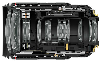

Inner and Rear Focusing Systems
AF lenses use actuator motors to move the lens elements into proper position. Therefore, the weight of each lens element greatly affects the focusing speed. Canon has developed technologies for inner focus and rear focus designs that reduce weight by making only some of the lens components (those affecting focus) movable. This change facilitates precise and high-speed autofocus control. The design also makes it easier to downsize the entire optical system, contributing to a smaller overall chassis and improved weight balance for easy holding. Since the entire lens is an integrated unit, this also makes it more robust and durable. While most people tend to focus on the AF performance of the camera (body) itself, in reality the AF performance of the RF lens is an essential factor in determining the AF performance of the entire system.
RF24-105mm F4 L IS USM (when focus distance is set to infinity)
Focus lens element: Moves in the direction of the mount as the focus distance changes from minimum-distance to infinity

Weatherproof
Interchangeable lenses are precise optical instruments and indispensable tools for the working professional. These tools must perform to match or exceed expectations in rugged conditions, rain or shine, indoors or out. Canon considers feedback from the professionals who actually use our lenses to be an important factor in the effort to boost lens performance. Professionals often have to work in severe conditions, subject to dust, wind, rain and snow. When Canon introduced a newly developed series of dust- and water-resistant super telephoto lenses in 1999, it assumed from the outset that its products would have to perform under severe conditions like these.
Today, the effort to meet these exacting standards continues. A rubber ring was introduced at the mount connection, to seal the gap between camera and lens from the elements when the two are attached. Highly dust- and moisture-resistant construction was also used for the focus ring, focus preset playback, and other moving parts. Switch panels and drop-in filter holders were rubberized. In today's age of digital imaging, the performance of professional lenses will be tested in an ever-growing range of environmental conditions, just as profesional demand that they should deliver superior imaging performance. Canon’s pursuit of excellent dust and water resistance continues in the RF L-series lenses. The entire system including lens, body, and accessories are designed to satisfy the most exacting demands of professional image makers.
* This cannot guarantee complete exclusion of water and dust from entry. The lens must be attached to the camera body to ensure dust- and moisture-resistant performance.

Heat Shield Coating
Canon’s efforts to address heat accumulation, with our traditional white-barrel lenses, have reached a new stage. To ensure that its lenses maintain outstanding optical performance when used in hot, direct sunlight, Canon adopted a heat-reflecting white coating for the barrel of some lenses, rather than the more traditional black. The history of white-barrel lenses stretches back to the FD600mm f/4.5 S.S.C and FD800mm f/5.6 S.S.C., two large-aperture telephoto lenses released in 1976 for single-lens reflex (SLR) cameras.* Canon’s in-house efforts to develop heat shield coatings originated as a way to make lenses more reliable under high temperature conditions. Through trial-and-error research into the selection and composition ratio of coatings Canon identified ways to enhance reflectivity toward light in the infrared spectrum, and developed new technologies to suppress temperature increases in both the coating film and the coated items. The final result is a series of white-barrel lenses that offer greater reliability when shooting in the hot sun.
Traditional white coating
Heat shield coating
Our heat shield coating uses infrared-reflecting pigments to enhance reflectivity against the “heat” component of sunlight. In the past, Canon lenses have offered either a carbon black or a white titanium oxide surface coating. However, carbon black strongly absorbs infrared waves, offsetting some of the reflectivity improvements offered by the heat shield coating. Our newly developed heat shield coating enhances reflectivity by replacing carbon black with an infrared-reflecting pigment. The coating also uses titanium oxide with a silica covering, making it more resistant to UV weathering. It is highly resistant to damage caused by scratching or abrasion. Lenses with the new coating retain Canon’s signature “white-barrel” color. Heralding in a new age for white-barrel lenses, the Canon heat shield coating was first introduced in the EF 400mm f/2.8L IS III USM and EF 600mm f/4L IS III USM, and is now used in all RF lenses with a white body.
