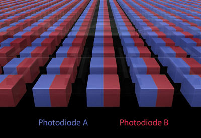

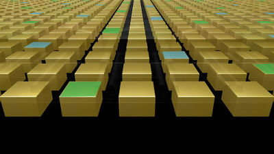

AF that covers the entire image sensor — not a limited number of “AF points”
    We’ll discuss in a moment how each pixel’s information is divided in two. But the important thing to initially understand about Canon’s Dual Pixel CMOS AF is that unlike competitive systems (as of April 2018), each and every pixel on the image sensor can be used for focus detection. In this conceptual illustration from Canon’s engineers, each “block” represents one pixel, and the blue and red halves of each represent the dual light-sensitive areas in each pixel, which are used for focus detection.
Dual Pixel CMOS AF, as of April 2018, is the only industry AF technology that uses every pixel on the imaging sensor to detect focus, and also to capture actual image information for still and video imagery. Focus can be detected anywhere, within a “live” area covering about 80% of the horizontal and vertical width of the entire CMOS imaging sensor.
This is important, and a reason for DPAF’s smoothness when focusing upon many subjects. Unlike many other systems using phase-detection to focus off the imaging sensor, DPAF does not use scattered pixels on the image sensor, nor does it use pixels exclusively for AF (and requiring the use image information from neighboring pixels to fill-in the missing image detail from those locations used for focus detection).
    Accordingly, you won’t hear claims of focus from “xx number of AF points” with Dual Pixel CMOS AF. It’s not restricted to limited numbers of locations on the image sensor, where dedicated pixels for AF replace ordinary light-gathering pixels, for focus detection exclusively. Information from each and every pixel is available, before image recording of a still image or video frame, to contribute to determining sharpness at the area of a subject you’ve asked it to focus upon.

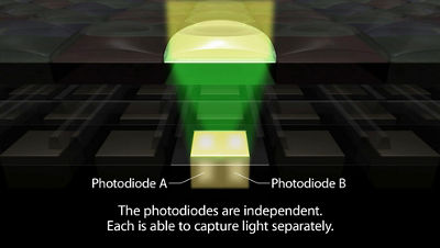

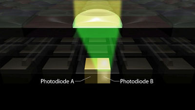

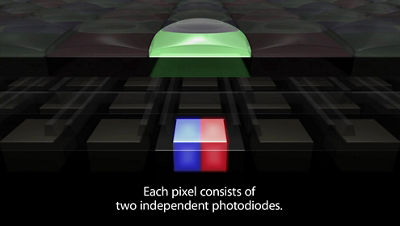

Dual Pixel CMOS: each pixel has TWO light-sensitive areas
The area of each pixel on a digital camera’s image sensor that records brightness is called a photodiode. This tiny area acts like a miniature light meter, and when an image is recorded, it generates an electronic signal in proportion to how much brightness it received. The greater the brightness at a given pixel, the greater the strength of the signal it generates.
Sophisticated processing from each pixel is used to assemble these millions of individual electronic signals into recognizable frames of video, or still images.
Dual Pixel CMOS AF takes this concept and expands upon it. Every pixel on the CMOS imaging sensor has its light-sensitive photodiode split in two. There’s a distinct left and right half, which for our purposes we can label the A and B parts of each pixel. Each can detect light, and during focus detection (before each video frame is recorded, or before a still image is actually recorded), it delivers two separate signals — independent ones for the A-side and B-side.
    The genius of Canon’s Dual Pixel CMOS AF is that when groups of pixels are assessed, the differences in read-outs from the A-side and B-side can detect focus. And in true phase-detect fashion, they don’t only see “sharpness,” but can instantly detect which direction the lens must move for sharp focus, and by how much. Again, this is done so effectively that there is no need for contrast-detection technology as a backup to ensure good, sharp focus.
