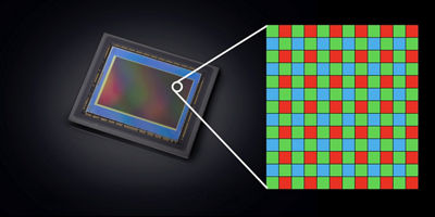

Canon CMOS Image Sensor
Digital imaging starts at the imaging sensor, where millions of individual pixels — each with a red, green or blue filter above them — gather light, and generate electronic signals in proportion to the light level each received. (Effect simulated in this graphic)
With JPEG images, these millions of individual signals are instantly sent to the camera’s primary processing unit, quickly analyzed, and utilizing information about the filter color for each pixel’s location, a finished image can be quickly generated and written to the camera’s memory card. This JPEG image will have color information interpolated and rendered; brightness, contrast, tonal range, fine detail, and so on all completed as it’s processed in-camera. The result is what has been termed a “finished file.”

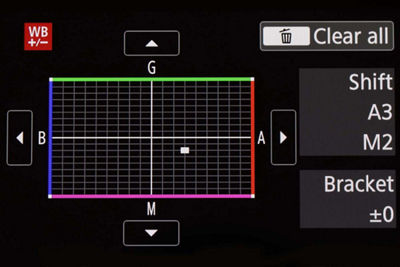

In fact, about the only in-camera settings that are “baked-in” with Canon RAW files are White Balance Shift (or WB Bracketing), and High ISO Noise Reduction.
White Balance Correction and WB Bracketing (not basic White Balance settings) and Long Exposure Noise Reduction are the only camera settings that actually affect pixels in Canon RAW files, and remain with the file regardless of what software is used to process it.

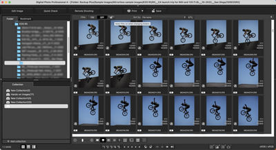

RAW Image Processing
Since a Canon RAW image isn’t ready for actual, full-resolution viewing after it’s been taken, it must be fully processed. That’s typically performed at the photographer’s computer, using RAW image processing software. Many recent mid-range and high-end EOS cameras have offered the option of in-camera RAW image processing, as well; we’ll discuss that shortly.
Digital Photo Professional (DPP) is Canon’s RAW file processing software — available free, for compatible Windows and Macintosh computers.
RAW image processing is actually one of the most proprietary, tightly-guarded aspects of modern digital camera design. Canon’s engineers, along with those of some competitors, consider the actual processing steps and procedure to be completely confidential, and they’re not shared with third-party software developers and never made public. And, RAW image processing varies greatly from one camera brand to the next — to some degree, even from one Canon model to the next.
RAW image processing, in general, is an extremely detailed series of repeated analysis of the brightness levels of a given pixel, the brightness of surrounding pixels, and the applications of hundreds or more complex calculations and algorithms — performed repeatedly, pixel-by-pixel, throughout the entire image area. Sometimes called “signal processing,” these calculations are the “secret sauce” of each camera maker’s RAW image processing. In most instances, makers of third-party RAW processing software have to reverse-engineer this to be able to process Canon .CR3 or .CR2 RAW files.
Accordingly, understand two basic things:
- RAW image processing will not be identical, using a camera maker’s software vs. that of a third-party software maker
- One of the reasons that Canon’s RAW processing software — called Digital Photo Professional, or sometimes abbreviated “DPP” — often takes longer to process individual RAW files is that Canon engineers have endowed it with extensive calculation strings. In the interest of shorter processing times, many third-party makers by-pass these small, incremental added steps, which produce increases to basic finished image quality.
Canon users are free to work with whatever RAW processing software they prefer, but keep the above points in the back of your mind.

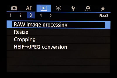

In-Camera RAW Image Processing
Another option, which can be especially handy if a RAW image shooter has a quick need for a smaller JPEG copy of a RAW file they’ve taken, is in-camera RAW processing. While Canon’s least-expensive cameras (such as EOS Rebel DSLRs, and compact mirrorless models like the EOS R100 and R50) don’t offer this, mid-range and more advanced models do. In-camera RAW processing is normally within the blue Image Playback area of the Menu, under “RAW image processing” or similar wording on the Menu.
The starting point, in the Playback Menu, for in-camera RAW processing
Basically, the camera’s DIGIC processor can take stored RAW data in a .CR2/.CR3 file, and then use either the camera settings that were in-place when the image was taken, such as White Balance, Picture Style and so on, or allow you to change those on the camera menu, and then process that RAW file into either a standard .JPG file, or a HEIF file (with potentially higher dynamic range and range of colors). Either way, the original RAW file is not affected — it remains on your camera’s memory card — and the processed JPEG or HEIF file is additionally written onto the memory card as well.
Processing in the computer, using most RAW file processing software applications, allows a greater range of adjustments to the original RAW file, than is usually possible with the available adjustments during in-camera RAW processing. Still, in-camera RAW processing is a great option, and one we suggest users try out to become acquainted with.

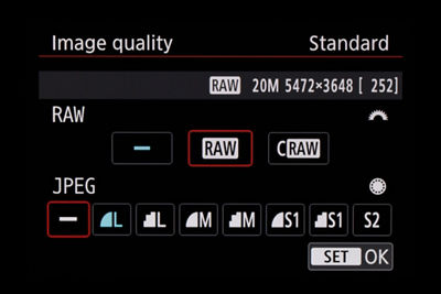

Reduced-Size RAW Image File Options
Many Canon EOS models from recent years have offered users the option of RAW files that take up less space on the memory card, and accordingly, when stored on your computer or external hard drives.
Canon EOS cameras allowing reduced-size RAW options will display it in the Image Quality menu screen. Whether a user selects RAW or C-RAW, it’s always possible to add any one of the JPEG options, and thus have RAW + JPEG recording on the memory card.
C-RAW image files:
EOS cameras in the past few years have offered an Image Quality option called “C-RAW,” which stands for Compact RAW (it is not “compressed RAW!”). Compact RAW files still use the full pixel resolution from your camera’s image sensor, so they always remain 24 million pixel files, or whatever your camera’s maximum resolution is. Unlike a conventional RAW file, however, the information is further reduced in-size, as it’s written onto the memory card. In keeping with the confidential nature of what’s happening within RAW files, Canon engineers have not disclosed precisely how these smaller files with C-RAW are being achieved, but just understand that the aim is to give you the processing flexibility and quality of RAW files, but in a smaller size.
For example, on a 45 million pixel EOS R5 camera, typical RAW file sizes (for the .CR3 file, on the memory card), would be approximately:
- RAW — 45.4 MB per file
- C-RAW — 22MB per file
(Actual file sizes for RAW images can and will vary slightly, from frame to frame, so don’t be alarmed if you see this in your .CR3 or .CR2 images.)
So what’s the difference with C-RAW images? Typically, the tonal range, especially in darker shadow areas, tends to be more extensive in the larger, “full” RAW image files. Normally, this isn’t something that’ll jump out at you, but for users who either accidentally or intentionally significantly under-expose a RAW image, and then lighten it within their RAW processing software, noise levels will typically increase more in C-RAW files. Otherwise, differences in RAW vs. C-RAW images are usually very slight.
M-RAW and S-RAW images:
Some EOS previous digital SLRs, beginning with the 50 million pixel Canon EOS 5DS and 5DS R models from 2015, used a different menu option to reduce RAW file sizes. In this case, M-RAW (“medium” RAW) and S-RAW (“small” RAW) options to images actually did reduce pixel resolution, to achieve smaller RAW files on the memory card. These cameras did not offer the C-RAW option, outlined immediately above — it was simply a different means of achieving smaller RAW file sizes, and arguably useful for photographers who didn’t expect to need full-resolution images for subjects like wedding reception candid images, and so on.
These reduced-res RAW files could still be processed conventionally; they simply had fewer final pixels, and thus reduced overall resolution.
