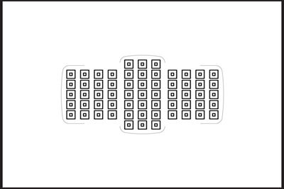

With digital SLRs, you worked with a number of pre-set focus points, permanently arranged around the central area of your viewfinder. While over time, the number of SLR focus points progressed from a single point in the center up to over 60 AF points (with cameras like the EOS 5D Mark IV or EOS 7D Mark II), there was always a fundamental design issue: AF points in DSLRs never covered anywhere near the full picture area.
A depiction of the 61 AF points in an EOS 5D-series DSLR, vs. the coverage of nearly 100% of the picture area with mirrorless cameras. Modern mid-range and high-end EOS mirrorless cameras, in fact, extend the horizontal range to virtually 100% of the width of the frame — more than is illustrated in this illustration.

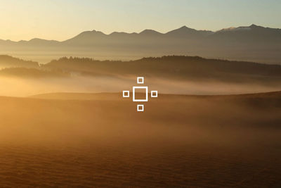

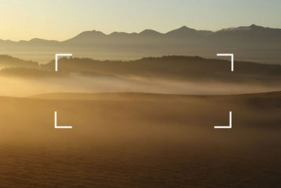

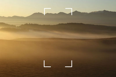

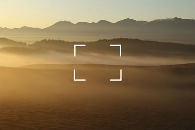

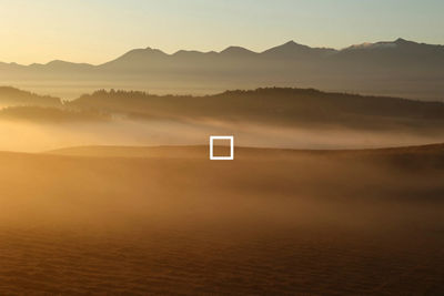

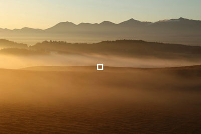

AF Area — the Size of What the Camera Focuses Upon
Photographers had the ability to gather multiple AF points to form a larger “cluster” of points for autofocus, with DSLR cameras like the EOS 7D models, or the EOS 5D Mark III and Mark IV models. And, within the boundaries of where AF points were located, these expanded AF areas could be manually moved to some degree.
But today’s Canon EOS R-series models allow a multitude of choices in where the AF system detects focus in a scene, ranging from Spot AF (a single, relatively small AF point) through Flexible Zone AF (three user-defined area choices, which can easily be re-sized, broadened or narrowed using camera controls). And, there’s Whole Area AF (on some models, it’s called “Face Detect + Tracking”), which makes 90%–100% of the picture area open for focus detection.
Again, the flexibility is incredible. Users who prefer to work carefully, using a single AF point, can easily do so, with the comfort of knowing they can manually move that AF point over essentially the entire frame. And users who want to work quickly and have the camera identify a subject and place focus upon it — even focusing on the eye of a detected human or animal subject — can do so, over nearly the entire frame. To repeat, the need to lock focus and re-compose is drastically reduced.
