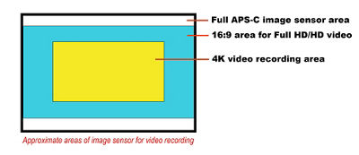

4K Recording and the APS-C size Image Sensor
When 4K recording is selected, it’s taken directly from a 3840 x 2160 pixel central area of the camera’s 24 million pixel image sensor. This means recording for 4K is from a cropped, central area of the image sensor — what you see in the viewfinder or LCD monitor during recording will be accurate, but keep in mind there will be a “crop effect” of about 1.67x, compared to what you’d get shooting still images with the EOS M50, or recording Full HD or HD video. If you recorded 4K video using the 15–45mm standard EF-M lens, lens coverage would be similar to what a 25–75mm lens would deliver for still images on the M50.
To be clear, for technical reasons, Full HD or HD video is always recorded using the full width of the camera’s imaging sensor. 4K video is always from the cropped central area.
The EOS M50 records 4K video directly from the central portion of its imaging sensor, shown above as the yellow area. This graphic is an approximate, contextual illustration, and not drawn exactly to scale. One advantage of using this smaller, central area of the image sensor for 4K recording is that it records exactly 3840 x 2160 pixels, so no “binning” or line-skipping steps occur as the 4K video is processed in-camera.

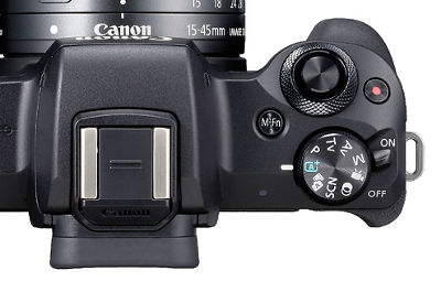

With 4K is selected in the menu, you normally start and stop video recording using a small button marked with a small red dot, immediately to the right of the camera’s shutter button. Press this again to stop recording.
Out of the box, you start and stop video recording by pressing the small button with the red dot, just to the side of the shutter button. The shutter button can be configured to be your video start/stop button… see the text immediately below. And, using the Custom Controls menu (it’s in the Custom Functions menu), the top M.Fn button, and numerous back buttons can likewise be configured to stop and start video recording, if you desire.
