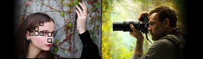

Active AF points over image of woman against a wall
Face Detect AF can simplify and speed-up the process of putting AF points, and sharp focus, upon a face in a scene. In this simulated graphic, you see the active AF points (during Automatic AF Point selection) indicated, showing that the AF system is upon the subject’s face. As in previous mid-range EOS models, Automatic AF Point selection is indicated by the thin outlines, surrounding the 45-point AF points in the viewfinder.
This can be a remarkable way to quickly put focus on faces, without taking the time to manually move an AF point or a zone of points from one part of the frame to another. It minimizes the problem of the camera inadvertently focusing on a distant background instead of a human subject, and perhaps even more important, is a great aid to ensure sharp focus actually falls upon a face — and not part of a subject’s clothes, or an accessory like a hat a that a subject may be wearing.

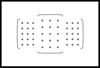

Automatic AF point selection with different AF Area settings

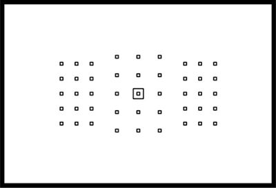

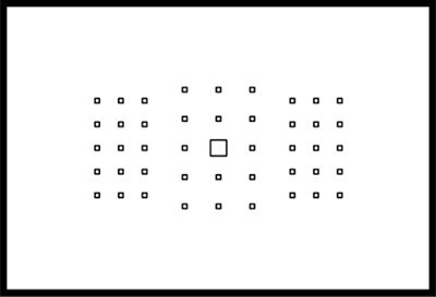

AF Area is the size of the active AF point(s) coverage in an EOS DSLR’s viewfinder. When using a single AF point (or the new Spot AF option), focus is limited to strictly that one AF point, and photographers can precisely control what their AF system focuses upon in a scene. Users are free to move that single AF point to any of the 45 AF point locations, manually. The EOS 90D’s new 8-way Multi-controller, on the back of the camera, makes this extremely easy and intuitive. And, the Multi-controller can be customized for immediate, direct manual AF point movement.
Single Point AF Area for EOS 90D
Spot AF Area options for EOS 90D
Experienced photographers who want precise control over the AF system can easily achieve this, with either the Single Point AF Area or Spot AF Area options in the EOS 90D. With either one, a single AF point can be manually moved to any of the 45 available AF point locations. Spot AF, using an even smaller sampling area for focus, is new in mid-range EOS DSLRs with the EOS 90D.

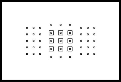

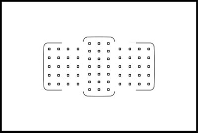

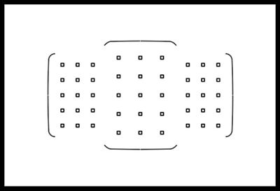

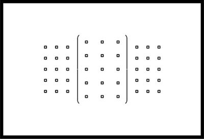

With larger AF Areas — Zone AF, Large Zone AF, and certainly Automatic AF Point selection — the camera will automatically decide which AF point(s) within the active area to use for a given scene and situation. Everything we’re saying about Face Detection and EOS iTR color metering applies in all three of these AF Area settings.
Zone AF for EOS 90D
Large Zone AF for EOS 90D
Automatic AF Point selection for EOS 90D
In any of the larger AF areas where the camera selects which AF point(s) to use, EOS iTR and Face Detection remain possible with the active AF points inside that AF Area. An example of Zone AF, Large Zone AF, and Automatic AF Point selection are all shown above.
