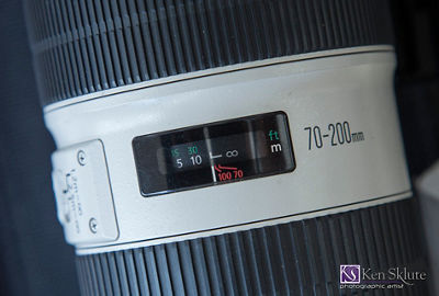

This is a technique that I employ most often: looking down on the top of your lens, you will find the infinity symbol at the end of your focus scale. Just to the left of that infinity symbol is a white line that looks like an L on its side. That is the Infinity Index. Align the vertical line of the infinity index with your focus index and you will be focused sharply at infinity.
Another favorite way of focusing at night is to use Live View.Activate the Live View function and use the image magnifier to zoom in to an area that has some light, and you can now focus accurately. Using the Live View method of focusing will be a great help for those lenses that do not have a focus scale or infinity index available.
