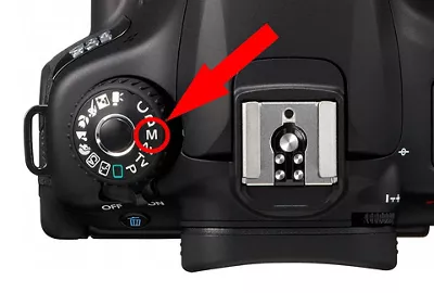

Turn your camera’s mode dial to “M” for Manual and manually select a shutter speed, aperture and ISO. Or, set the camera to its “Bulb” setting — more on that in a moment.
For the best and most consistent results, make sure that your exposure and lens focus are both set to Manual (and try pre-setting the lens focus to infinity.)
Setting Camera Dial to M
Even though we speak at length about dialing-in your own specific shutter speeds, this is one instance where (usually) shutter-priority (the Tv mode) on your camera won’t be an ideal choice. Like any form of automatic exposure, the Tv mode can be fooled by broad expanses of dark sky and end up over-exposing the fireworks you’re hoping to capture.

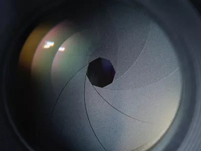

CAMERA SETTINGS: LENS APERTURES
Manual exposure mode requires you to set an appropriate lens aperture, as well as shutter speed. Here are a few points to keep in mind:
If the fireworks look too bright and washed-out, adjust your aperture setting before changing the shutter speed or ISO.

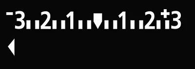

  • Don’t pay attention to the metering scale in your viewfinder! Normally a reliable tool when setting exposure in Manual mode, a "correct" reading on this scale will try to guide you into a middle-gray rendering of this dark expanse — exactly what you don’t want in fireworks pictures. Set an initial shutter speed and lens aperture in Manual mode, shoot a picture or two and look at them on your LCD monitor. Adjust shutter speed and/or lens aperture as needed but, again, fireworks are an unusual type of photographic subject, so ignore that metering scale!
Fireworks are one instance where you want under-exposure, so that your sky is rendered near-black in tone. Your manual meter scale should read something like this, rather than indicating correct exposure.

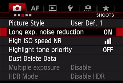

Any time a digital camera’s shutter is held open for longer than a few seconds, for technical reasons, it’s possible to see an increase in visible digital “noise” in the picture. This is sort of like film grain in old photos taken in low light. As shutter speeds get progressively longer (10 seconds, 30 seconds, 1 minute and so on), this noise can build up and become increasingly apparent. Most Canon cameras have an available feature called “Long Exposure Noise Reduction,” which can be activated by either a Custom Function or menu setting.
Long Exposure Noise Reduction is a useful feature (shown here on an EOS 5D Mark III menu) when shooting fireworks in "Bulb" mode, particularly for exposures longer than 30 seconds.
Camera Menu - Long Exposure Noise Reduction Setting
Some users wonder why this noise reduction feature isn’t always on at all times. The answer is that using it can slow down your shooting of one picture after another. To do its job, Long Exposure Noise Reduction has to re-energize your imaging sensor and take a “blank” exposure, after your actual picture is taken, for the same length of time. During this time, you cannot shoot another picture — the red card “busy light” on the back of the camera stays on until the process is completed. If you shoot a 30 second exposure, the camera has to be tied-up for an additional 30 full seconds to process before your next picture can be taken. This can be a problem during rapid repeating bursts of fireworks.
As a practical matter, the noise build-up at shutter speeds of 30 seconds or shorter (10 seconds, 1 second and so on) is so minimal that you’re usually better off leaving this noise reduction off for fireworks shooting. But if you do anticipate using the “baseball hat” technique and utilizing longer bulb exposure times, you may find a noticeable quality boost if this feature is set to on. Long Exposure Noise Reduction only applies to images taken at shutter speeds of one second or longer and is ignored at shorter speeds like 1/2 second, 1/60th and so on. Finally, don’t confuse this with “High ISO Noise Reduction” on your camera’s menu. They’re two separate and independent things.
