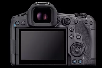

Back of Camera
In this first installment, we’ll look at the first thing most users see in their cameras — the viewfinder. The gains available with the sophisticated Electronic Viewfinders (EVFs) in mirrorless cameras really should be considered, even by hardened DSLR enthusiasts.
