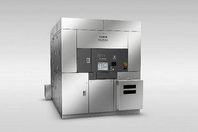

MELVILLE, NY, April 8, 2021 – Canon U.S.A., Inc., a leader in digital imaging solutions, today announced that its parent company, Canon Inc., has launched the FPA-5520iV LF Option for back-end process semiconductor lithography systems. This device features an i-line stepper1 with a 1.5 micrometer2 resolution and a wide exposure field of 52 mm x 68 mm for advanced packaging3.
In the field of semiconductor chip performance enhancement, alongside the miniaturization of circuits in front-end process of semiconductor manufacturing, higher-density packaging in back-end processes has become a valuable resource within this market. Advanced packaging with high performance requires fine redistribution layer patterns4, and in recent years, semiconductor lithography systems have been used for this purpose. Inheriting the same basic functionality of its predecessor model, the FPA-5520iV, released in July 2016, the new FPA-5520iV LF Option for advanced packaging achieves a wide exposure field of circuit patterns to meet a variety of advanced packaging needs including heterogeneous integration5.
As a result of its projection optical system, the Option recognizes single exposure with a large field of 52 mm × 68 mm — more than four times the standard exposure field (26 mm x 33 mm) of front-end process lithography systems, making support for integrations possible, in which multiple large semiconductor chips are bonded. In addition, with a high resolution of 1.5 micrometers, it is possible to expose fine redistribution layer patterns, thus supporting a variety of advanced packaging types. What's more, by introducing this high resolution option, redistribution layer patterns can be exposed with a high resolution of 1.0 micrometers.
The FPA-5520iV LF Option inherits the basic performance of the FPA-5520iV, which has received praise for its ability to handle warped reconstituted substrates6, an issue which can occur in packaging layers during the mass-production process. This system also offers enhanced availability by detecting alignment marks on the reconstituted substrates with large chip array variations.
