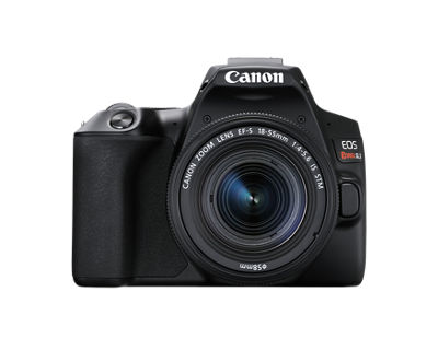

Type
Digital AF/AE single-lens reflex camera with built-in flash
Recording Media
SD/SDHC/SDXC memory cards
  • SD speed class-compatible
  • UHS-I compatible
  • High-speed writing is supported when a UHS-I compatible SD card is used.
  • Compatible with Eye-Fi cards.
  • Multimedia cards (MMC) cannot be used (card error will be displayed).
Image Format
Approx. 22.3 x 14.9mm (APS-C)
Compatible Lenses
Canon EF lenses (including EF-S lenses, excluding EF-M lenses)
Lens Mount
Canon EF mount
Type
CMOS sensor (supporting Dual Pixel CMOS AF)
Pixels
Approx. 24.1 megapixels
Pixel Unit
Approx. 3.72 &micro;m square
Total Pixels
Approx. 25.8 megapixels
Aspect Ratio
3:2 (Horizontal : Vertical)
Color Filter System
RGB primary color filters
Low Pass Filter
Installed in front of the image sensor, non-detachable
Dust Deletion Feature
  1. Self Cleaning Sensor Unit
    • Removes dust adhering to the low-pass filter.
    • Self-cleaning activated automatically (taking approx. 2 sec.) when power is turned on or off. Manual operation also possible (taking approx. 8 sec.).
    • After the cleaning is performed, the camera will automatically restart (Power OFF to ON).
    • When you use Multi Shot Noise Reduction, Clean now cannot be selected.
  2. Dust Delete Data acquisition and appending
    • The coordinates of the dust adhering to the low-pass filter are detected by a test shot and appended to subsequent images.
    • The dust coordinate data appended to the image is used by the provided software to automatically erase the dust spots.
  3. Manual cleaning (by hand)
Recording Format
Compliant to Design rule for Camera File system 2.0 and Exif 2.31*
* Supports time difference information
Image Format
JPEG, RAW (14-bit Canon original), C-RAW (Canon original)
File Size
3:2 Aspect Ratio
Large: 6000 x 4000
Medium: 3984 x 2656
Small 1: 2976 x 1984
Small 2: 2400 x 1600
RAW: 6000 x 4000
4:3 Aspect Ratio
Large: 5328 x 4000*
Medium: 3552 x 2664
Small 1: 2656 x 1992
Small 2: 2112 x 1600*
RAW: 6000 x 4000
16:9 Aspect Ratio
Large: 6000 x 3368*
Medium: 3984 x 2240*
Small 1: 2976 x 1680*
Small 2: 2400 x 1344*
RAW: 6000 x 4000
1:1 Aspect Ratio
Large: 4000 x 4000
Medium: 2656 x 2656
Small 1: 1984 x 1984
Small 2: 1600 x 1600
RAW: 6000 x 4000
* Indicate an inexact proportion.
  • Multiple aspect ratios (1:1, 4:3, and 16:9) can be specified in Live View Shooting.
  • Values for Recording Pixels are rounded off to the nearest 100,000th.
  • JPEG images are generated in the set aspect ratio.
  • RAW/C-RAW images are generated in [3:2], and the set aspect ratio is appended.
File Numbering
  1. File numbering methods
    • Continuous numbering
      • The numbering of captured images continues even after you replace the card.
    • Auto reset
      • When you replace the card, the numbering will be reset to start from 0001. If the new SD card already contains images, the numbering will continue from the last recorded image in the card.
  2. Manual reset
    • Resets the file number to 0001, and creates a new folder automatically.
RAW + JPEG Simultaneous Recording
Simultaneous recording is possible using a combination of RAW and JPEG/Large(Fine).
Color Space
sRGB/Adobe RGB
Picture Style
  1. Auto
  2. Standard
  3. Portrait
  4. Landscape
  5. Fine Detail
  6. Neutral
  7. Faithful
  8. Monochrome
  9. User Defined 1-3
    • In Basic Zone modes, [Auto] will be set for and of the mode, and [Standard] will be set for other modes.
    • In Creative Zone modes, you can select or set the Picture Style.
    • [Auto] is the default setting for [User Def. 1-3].
Settings
  1. Auto (Ambience priority/White priority)
  2. Daylight
  3. Shade
  4. Cloudy*
  5. Tungsten light
  6. White fluorescent light
  7. Flash
  8. Custom (Custom WB)
* Effective also in twilight and sunset.
Auto White Balance
Option between ambience priority and white priority settings
Color Temperature Compensation
Blue/amber bias: &plusmn;9 levels
Magenta/green bias: &plusmn;9 levels
* Corrected in reference to the current WB modes color temperature.
* Blue/amber and magenta/green correction can be set at the same time.
Type
Eye-level SLR (with fixed pentaprism)
Coverage
Approx. 95% vertical/horizontal coverage (at approx. 19mm eye point and Large image size)
Magnification
Approx. 0.87x/24.5&deg; (with 50mm lens at infinity, -1 m-1)
Eye Point
Approx. 19mm (At -1m-1 from the eyepiece lens center)
Dioptric Adjustment Correction
Adjustable from approx. -3.0 to +1.0 m-1 (dpt)
Focusing Screen
Fixed
Mirror
Quick-return half mirror
Viewfinder Information
Spot metering circle, AF point activation indicator, AF point, ISO speed indicator, Focus indicator, Maximum burst, ISO speed, Highlight tone priority, Exposure level indicator, Exposure compensation amount, AEB range, Red-eye reduction lamp ON, Exposure compensation, Aperture, Shutter speed, Bulb exposure, FE lock, Busy, Built-in flash recharging, No card warning, Card error, Card full warning, error code, Flash exposure compensation, High-speed sync, FE lock / FEB in-progress, Flash-ready, Improper FE lock warning, AE lock, AEB in-progress, Warning icon
Depth of Field Preview
Provided with customized DISP button settings.
Type
TTL secondary image-forming phase-difference detection system with AF-dedicated sensor
AF Points
9 points
Center AF point is AF cross-type supporting f/5.6.
Center AF point is vertical line-sensitive supporting f/2.8.
Other AF points is vertical line-sensitive or horizontal line-sensitive AF supporting f/5.6.
AF Working Range
With One-Shot AF, at 73°F/23°C, ISO 100
EV -0.518 (center AF point)
EV 0.518 (other AF points)
(Based on Canon&rsquo;s testing standards and environment)
Focusing Modes
  1. Autofocus
    1. One-Shot AF
    2. AI Servo AF
    3. AI Focus AF
      • Switches between One-Shot AF and AI Servo AF automatically.
  2. Manual focus
AF Point Selection
  1. Manual selection
  2. Auto selection
    • Manually selectable in Basic Zone modes (except Special Scene Candlelight and Creative Filters Fish-eye effect and Miniature effect)
AF Assist Beam
  1. Built-in Flash
    • Not supported
  2. External Flash
    • Infrared
    • Intermittent firing
Metering Modes
63-zone metering sensor
  1. Evaluative metering (linked to all AF points)
  2. Partial metering (center, approx. 9.0% of viewfinder)
  3. Spot metering (center, approx. 4.0% of viewfinder)
  4. Center-weighted average metering
Metering Range
EV 1 - 20 (at 73&deg;F/23&deg;C, ISO 100, evaluative metering)
Exposure Control Systems
  1. Creative Zone
    1. Program AE (shiftable)
    2. Shutter-priority AE
    3. Aperture-priority AE
    4. Manual exposure (including bulb)
  2. Basic Zone
    1. Scene Intelligent Auto (Program AE/ non-shiftable)
    2. Special Scene
      1. Portrait
      2. Group Photo
      3. Landscape
      4. Sports
      5. Kids
      6. Close-up
      7. Food
      8. Candlelight
      9. Night Portrait
      10. Handheld Night Scene
      11. HDR Backlight Control
    3. Creative Filters
      1. Grainy B/W
      2. Soft Focus
      3. Fish-eye effect
      4. Water painting effect
      5. Toy camera effect
      6. Miniature effect
      7. HDR art standard
      8. HDR art vivid
      9. HDR art bold
      10. HDR art embossed
    4. Self Portrait
ISO Speed Range
Manual Setting
Normal ISO 10025600 (in whole-stop increments)
Expanded ISO 51200
  • When Highlight tone priority is set to [Enable] or [Enhanced], minimum ISO speed is ISO 200.
  • Maximum ISO speed cannot be set to H (equivalent to ISO 51200).
Auto ISO Speed Settings
Shooting Mode No Flash Built-in Flash External Flash
P Program AE ISO 100* 125600* 2 ISO 100* 11600* 2 ISO 100* 11600* 2
Tv Shutter-priority AE
Av Aperture-priority AE
M Manual Exposure
Bulb Exposure ISO 400 ISO 400 ISO 400
Scene Intelligent Auto ISO 1006400 ISO 100-3200 ISO 4001600
Special Scene Portrait ISO 1006400 ISO 1001600 ISO 100-1600
Smooth skin
Group Photo ISO 100-3200
Landscape ISO 1001600 Does not fire Does not fire* 3
Sports ISO 1006400 ISO 4001600
Kids ISO 4001600
Close-up
Food
Candlelight Does not fire Does not fire* 3
Night Portrait ISO 100-800 ISO 100-800 ISO 100-800
Handheld Night Scene ISO 100-12800 ISO 1006400 ISO 100-6400
HDR Backlight Control ISO 100-6400 Does not fire Does not fire* 3
Creative Filters Grainy B/W ISO 100-6400 ISO 100-1600 ISO 100-1600
Soft Focus
Fish-eye Effect
Water Painting Effect
Toy Camera Effect
Miniature Effect ISO 100-6400
HDR Art Standard ISO 100-6400 Does not fire Does not fire* 3
HDR Art Vivid
HDR Art Bold
HDR Art Embossed
  1. ISO 200 when [Highlight tone priority] is set to [Enable] or [Enhanced].
  2. Varies depending on the maximum of [Max for Auto].
  3. Only the AF-assist beam fires.
Exposure Compensation
Manual ±5 stops* in 1/3- or 1/2-stop increments*
AEB ±2 stops in 1/3- or 1/2-stop increments
* Up to ±3 stops when [Shooting screen: Guided] is set.
AE Lock
  1. Auto AE lock
    • In the One-Shot AF mode with evaluative metering, AE lock takes effect when focus is achieved.
  2. Manual AE lock
    • In the P, Tv, Av and M modes, enabled with the AE lock button. (Press again to update.)
    • Possible with all metering modes.
Type
Vertical-travel, mechanical, focal-plane shutter with all speeds electronically-controlled
  • Electronic 1st curtain and mechanical 2nd curtain
Shutter Speeds
Creative Zone: 1/4000 to 30 sec., bulb
* X-sync at 1/200 sec.
Basic Zone: 1/4000 to 1 sec.
Shutter Release
Soft-touch electromagnetic release
Self Timer
10-sec. delay, 2-sec. delay, continuous shooting after 10 sec. (2 to 10 shots)
Shutter Lag Time
With SW-1 ON, time lag between SW-2 ON and start of exposure: approx. 0.075 sec.
  • Based on Canon testing standards.
  • Time lag with the aperture stopped down by 3 stops or less from the open aperture.
  • Release time lag will become longer for Live View shooting, Silent single shooting or Silent continuous shooting.
Flash Metering
E-TTL II autoflash (Evaluative, Average), FE Lock
Flash Exposure Compensation
&plusmn;2 stops in 1/3- or 1/2-stop increments
  • Flash exposure compensation for built-in flash and external Speedlite can be set from the camera.
FE Lock
Provided
External Flash Settings
The camera can set the following with EX series Speedlites:
  • The actual setting options will differ depending on the Speedlite used.
  1. External flash control
    • Flash firing, E-TTL II metering, Flash mode, Wireless functions, Flash zoom, Shutter synchronization, Flash exposure compensation, Flash exposure bracketing and Clear settings.
    • The radio wireless flash functions can be set from the camera.
  2. External flash Custom Function setting
    • The setting options for both (1) and (2) will differ depending on the Speedlite used.
Drive Modes and Continuous Shooting Speed during Viewfinder Shooting
  1. Single shooting
  2. High-speed continuous shooting
    • Max. approx. 5.0 shots/sec. (One-Shot AF and AI Servo AF)
    • Maximum continuous shooting speed with 1/500 sec. or faster shutter speed, maximum aperture (varies depending on the lens), with a fully-charged Battery Pack LP-E17 and at room temperature (73°F/23°C).
