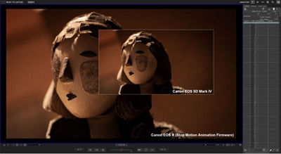

Larger Live View
Live view is critical to animators creating stop motion animation films. Animators use the remote live view of the camera to review critical details and make decisions within stop motion animation software, like Dragonframe. Canon’s Stop Motion Animation firmware increases the Live View to 1920x1280 - helping animators see subtle movement for refined animation.
    This is a comparison of the new Live View resolution of 1920x1280 (full screen) versus the original size of 960x640 (small inset). The large preview image makes it easier for the animators to have confidence in the shot and can improve the overall quality of the scene.

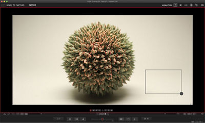

USB Manual Focus Peaking
    Seeing Focus Peaking on the full screen allows the animator to precisely capture fine detail and adjust for desired depth of field.
    Critical focus on a subject's eyes (red edge) gives the animator the confidence that the scene flows as directed.
