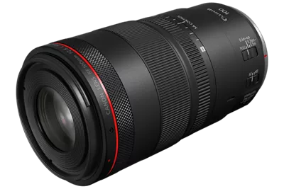

Canon RF100mm F2.8 L Macro IS USM
While the RF 100mm F2.8 L Macro IS USM is considerably more expensive than the other macro lenses in this article, it is arguably one of the most used macro lenses in the Canon lens line. The lens is capable of capturing life size and beyond images (up to 1.4x magnification), and is a staple in many professional kits. Its ability to be used for a variety of productions and capture incredibly detailed images make it a standard piece of kit for people shooting events, products and nature. It also doubles as an excellent lens for portraits and talking heads. This lens also has a unique feature which is the Spherical Aberration (SA) Control Ring which allows the user to deliberately add an optical soft-focus effect, when desired. (With its SA Control Ring at the “0” position, it’s a super-sharp macro lens.)
RF100mm F2.8 L Macro IS USM - Slanted 3 Quarter View

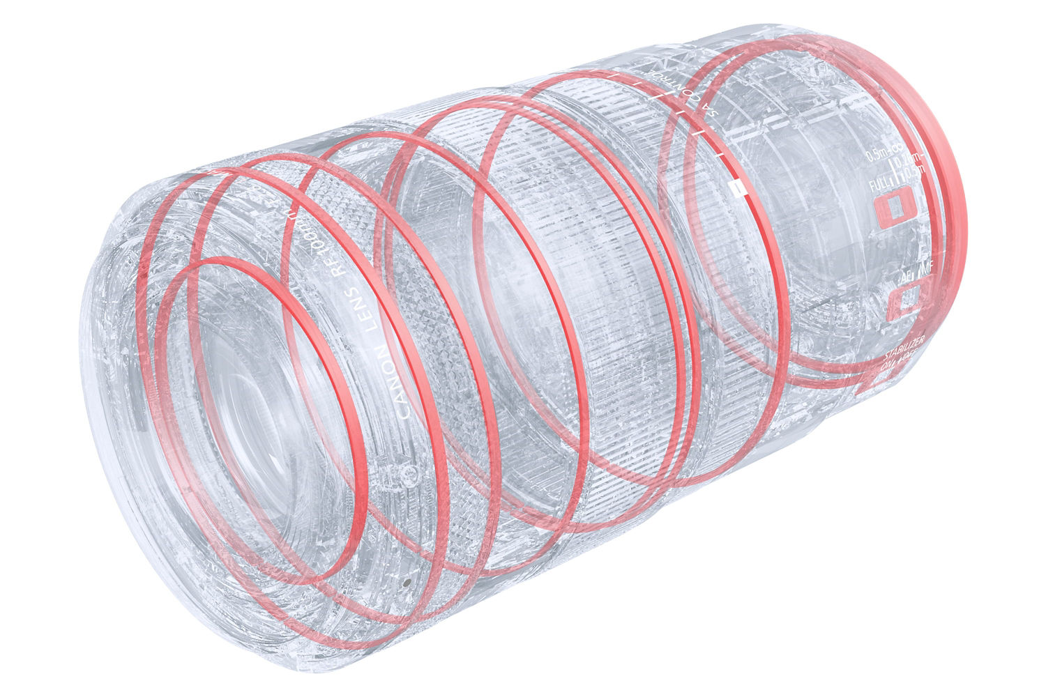

Seals for the RF100mm F2.8 L Macro IS USM
  • Minimum Focus Distance: 10.2 in. / 0.26 m. This lens stands out with a maximum magnification ratio of 1.4:1 (1.4x), exceeding the traditional 1:1 offered by most macro lenses. This enables small, close-up subjects to be captured both life-size and larger than life-size.
  • Close-up Magnification: 1.4x (greater than life-size)
  • Hybrid Image Stabilization (IS): Added optical stabilization specifically tailored to close-up shooting correction
  • Spherical Aberration (SA) Control Ring: Allows intentional soft-focus effects, and changes in background bokeh character.
  • Dual Nano USM Autofocus: Allows for extremely fast, reliable & silent autofocus.
  • L-Series Build Quality: Weather-sealed, robust, and professional-level optics.
